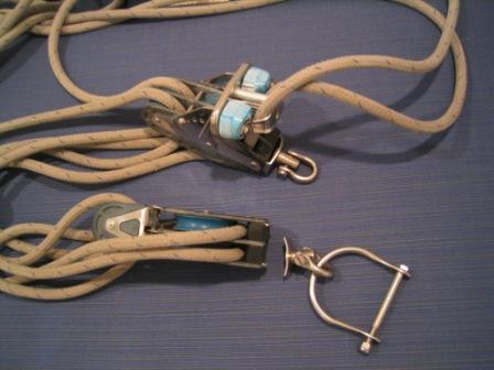

Today Ma Nature was blowin' 35+ out of the north, pushin' 10-12+ footers on Lake Michigan onto the shores of Chicago; quite the display but not the day you want the harbor to call and say "your boom broke free, nothing appears damaged and we secured it temporarily".I raced in before dark, took the tender out to the can (only the 5th passenger of the day) and found the Easy Block mainsheet system laying in the cockpit. The picture shows how the upper block had parted from the boom bail. A bit un-nerving to think it happened in the harbor, un-attended, after an entire season of full range wind speeds.It's a 20 year old system that worked well with 3/6:1 coarse/fine adjustments, but gave no hint that it was about to give it up. Guess I know what I want Santa to drop down the chimney with this Christmas.I guess the lesson learned is be vigilant, inspect your equipment and assume nothing. And be thankful when you avoid a big problem.
