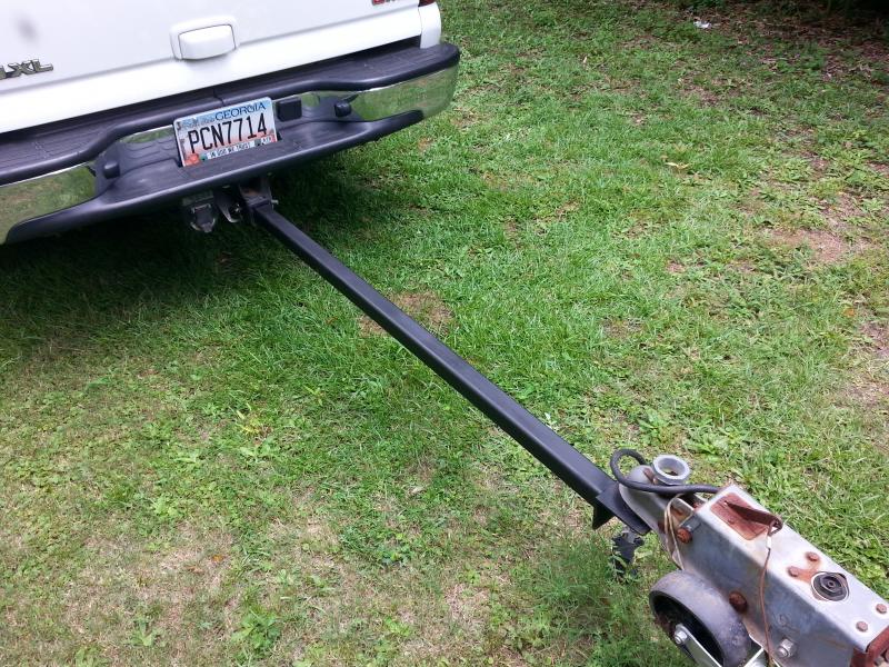

I actually wanted one but was told the torque would destroy the rear end of my tow vehicle. PLEASE let us know how it works out!

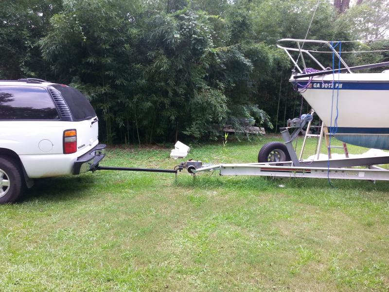

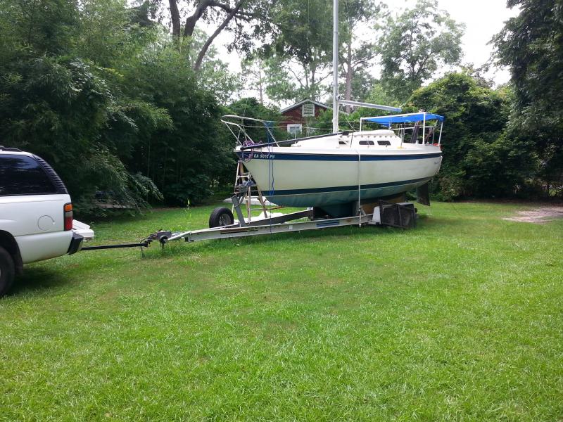

Ill let you know how it works. I dont have very much tongue weight so hopefully works good. Ill take and post pics next time I go

I'm worried that moving the pivot point so far from the hitch will cause issues ie bending. I'm also curious to see how much it's going to affect steering in reverse.

A 5 ft. Extension? Where did you get it? The best I could find is 3 foot!

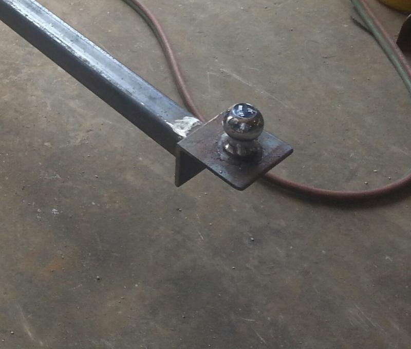

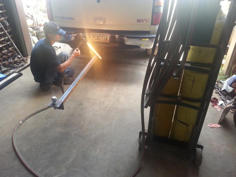

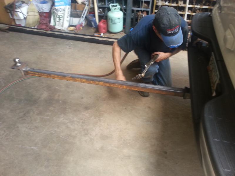

Rs8684. .. hey. I found a local metal supply shop and told the guy I needed 5 ft of square tubing. I talked him into helping me make it. You could go to any metal shop and they can help you. The whole thing cost me $60.00 for material and labor. It took 3 minutes to weld

Did you try backing with it? I'm really interested to see how it does.

Yes I did. Because it is attached to the vehicle I had no problem. Just like normal hitch only longer. Still say go sloooow lol
