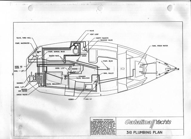

I have no tee that I know of
Where is the tee located? That does not seem to make a lot of sense to hook two thru hulls together. Per the 310 drawing from the manual they are not connected either. Let me know and I will have Erika look for it.

Putting both together makes sense in that it is one less hole in the bottom. The Tee is located about two feet directly outboard and slightly foreword of the two thru hulls, attached to a block glued to the hull up close to the decking for the berth above. Looks like there was a change between 2002 and 2003, but I don't have my manual handy. Does your shower sump and galley sink drain share the same thru hull? Does your fridge have a drain line to bilge?

Here is what I have
Head sink has separate thru hull.
Galley sink has separate thru hull.
Shower sump and refrigerator share same thru hull right next to galley sink.
Head has separate thru hull for flushing water.
Macerator has separate thru hull.
Engine intake has separate thru hull.
Really way too many thru hulls.
