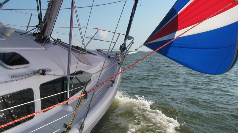

Someone here on the forum posted this once.... I saved it because I thought it was cool and would work great with my cruising chute. There was also some information I saved on who makes it but can not find it right now. May be they will see this and chime back in.

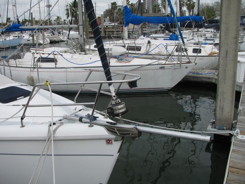

onecoolair,
It's my boat in the photo. My boat is over at the Boardwalk Marina. I made the bowsprit out of aluminum conduit. It works great and getting the tack of the a-sail a couple feet out in front of the boat makes a big difference. I'd like to say I did a lot of calculation and experimenting to come up with how long to make it, but it's what will fit into the back of my Avalanche. You can't have the anchor on the roller with it, but undo one cleat hitch and the bowsprit comes right off. I've got some 3" aircraft tubing to rebuild it with, because the 2" conduit bends when the apparent wind gets over 12 knots. I probably have less than $100 into it and I didn't have to drill any holes in the deck. I plan on being out on the bay Saturday with the a-sail out on the sprit.

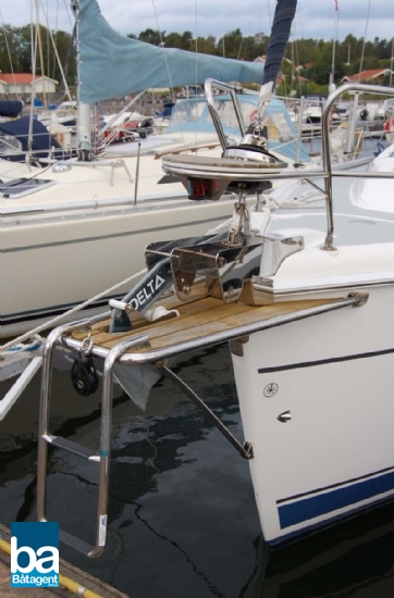

Patrik
Apr 1, 2008
66
Hunter 356 Stockholm
This is how i did. No interference with the anchor and a good platform men going ashore
