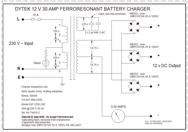

My 1996 H376 came with one fitted from new - 'orrible heavy thing.
Circuit diagram as below - dated 2002 and long after removal from my boat. I think Charles Industries is still in existence - see address on drawing. DON'T do my mods as they make it worse! Sorry about the poor drawing quality but this site reduces the file size. Anyone wanting the full info please e-mail me through this site.
Note:- The UK is on 240V so for 110V mains connect both primary windings in parallel.
Unit consists of a ferro-resonant circuit with a three legged transformer, one leg of which has an air gap.
The claimed performance is that the charger output is stabilised against incoming mains voltage variations only. Otherwise it is just an old fashioned taper charger with no protection against overcharging etc.
I took mine home to charge car batteries only - and then not very well.
