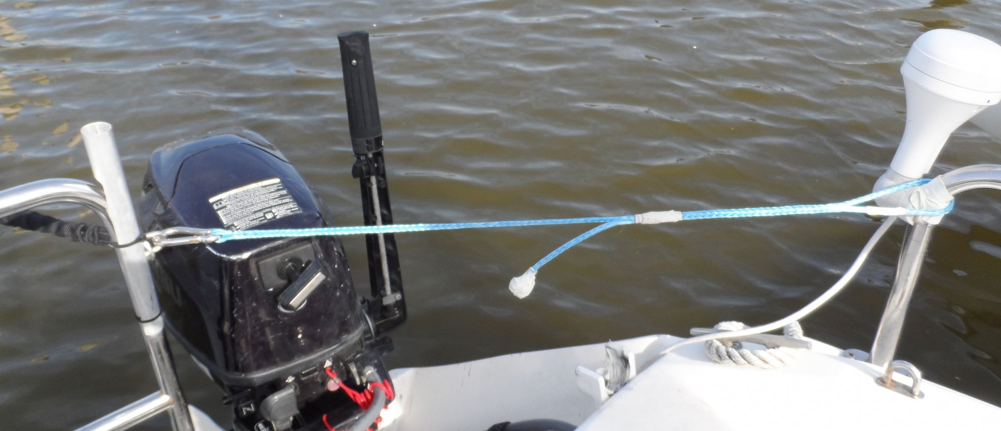

I've used whoopee slings + wire gate climbing carabiner for this and still do; they are light and simple, but tend to be hard to adjust after they age, so I would go with a pelican hook-type if it is used frequently. For a gate that is only infrequently used, a great solution. Adding a little athletic tape for grip in the right places helps. The trick is that you need a tiny bit of slack before they will let go and release.

A whoopee sling is about 25% weaker than a spliced eye according to Samson. It will not slip. I don't under stand the friction question.
This replaced a stainless line that was stiff and in the way. The tape is NOT at the rope exit, but rather is there to make grabbing the rope easier for making adjustments. Just like making an eye splice except ...
  • Leave the tail very long.
  • Put a stopper knot on the end so that it cannot accidentally pull in. Some folks use a smaller backsplice (looks neat), but the knot is easier to grab. Function over form for me.
  • No lock stitching. Obviously.
The only downside is that if you pull it very tight it can jam. You need a micro bit of slack in order to release the whoopee sling. Practice.

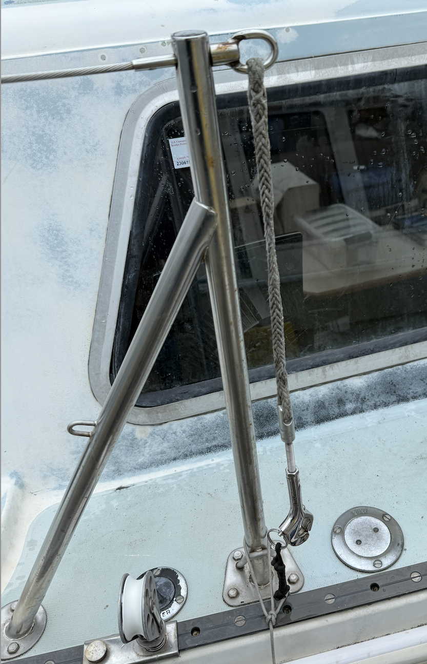

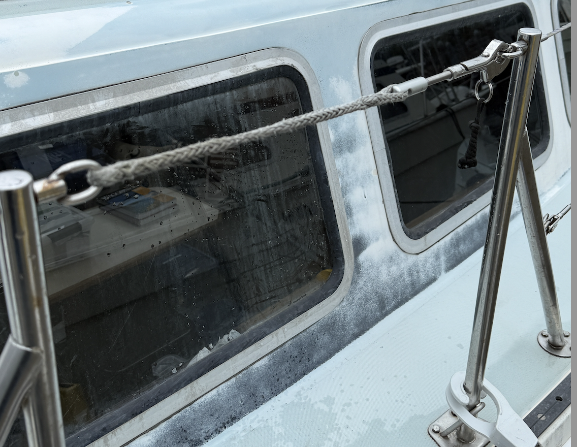

I installed fixed length dynema gates on my boat back in 2016. I’ll take a photo when it gets light. I used pelican hooks. I like their hand feel. When released they hang vertically out of the way. I’ve not observed any sagging. If such occurred it could be taken up by adjusting the pelican hook. They have been in the weather 365 for 9 years. I chose to bury the ends of an eye splice. This has the additional benefit of increasing the hand feel by doubling the diameter of the line.

Here are the images I promised.
Note: I have a defined gate supporting the stanchion, not just a single stanchion.

23,853
The new line shine of the outside fibers is starting to show age.
