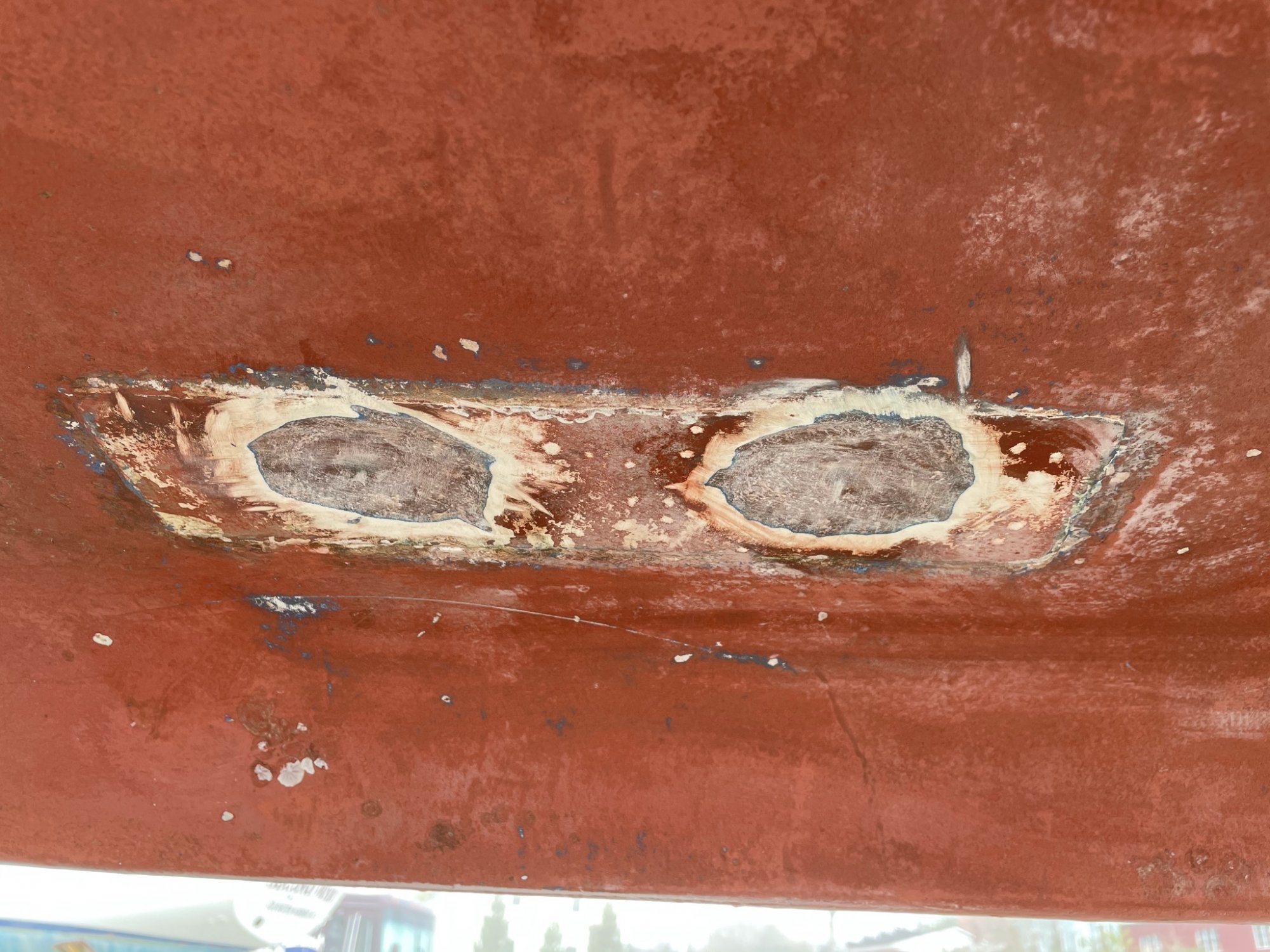

So my dynaplate started leaking. On Karma, it's the bump in the hull that has many coats of antifouling and therefore has been useless way before I've owned her. I've removed the device and have purchased a replacement. Question is to I install the new one and deal with another maintenance item, or do I glass over the two holes and press on.

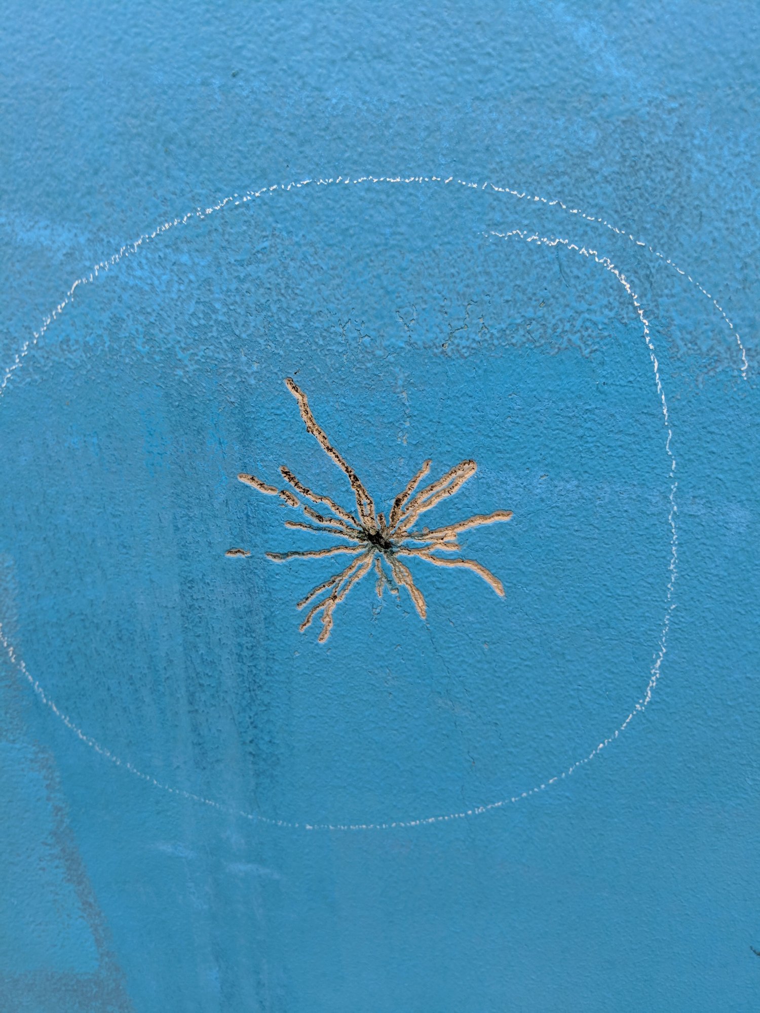

As for the question on Lightning handling, bonded thru hulls are generally considered safer than not. Lightning is a pretty high voltage, and it’s going to find its way to the water somehow. True that on its way it might damage a thru hull if it’s really a bad direct hit, but if it can’t get out the thru hull it’s more likely to go out the glass.
A boat in our marina was hit a couple years ago. It ended up with about 80 of these star bursts on the bottom. Lots of burnt glass under each one that had to be relaid. I think the thru hulls were replaced too, but it didn’t sink.

My fix for the dynaplate :) Filled the holes from the inside with thickened epoxy. Then ground out and laminated with an epoxy/fiberglass sandwich. Ugly now but will be faired and painted over.
