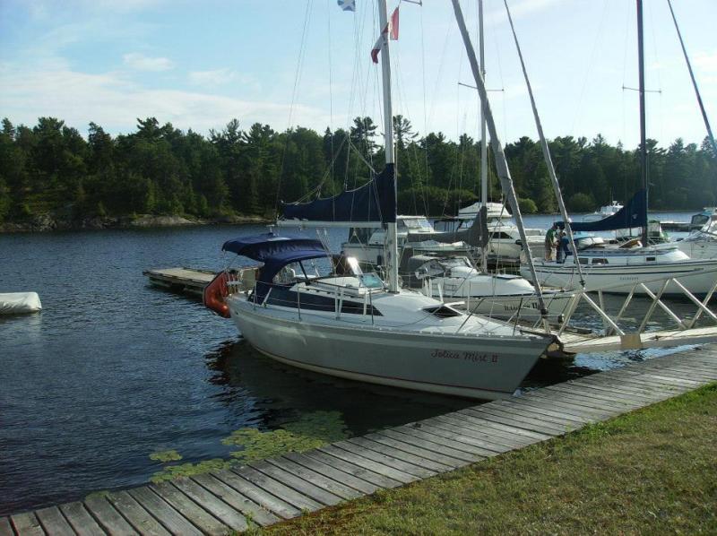

Having used lazy jack system in the past, for the last 4 seasons I used lazy jack with integrated sail cover system. I will never go back to any other setup. While some people complain of lazy jacks being a problem while raising the sail (my main has full battens), possibility of simply lowering the main into the lazy bag and closing the zipper is, for me, essential. While I sail with the "admiral", most of time I am single handling the boat.
