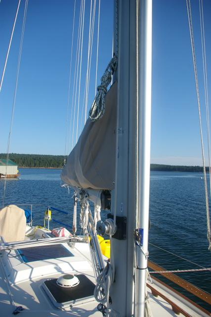

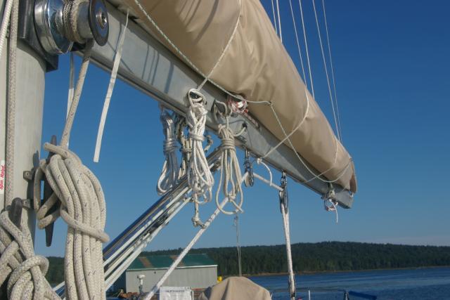

Lazy Jacks
I did have fold aways lazy jacks on my 2001 Hunter that I really did like and pretty much copied and made my self,it was trial and error with some cheap line or you could use bungee line.

seadaddler-did you have bullet blocks or something like that near the spreaders?
