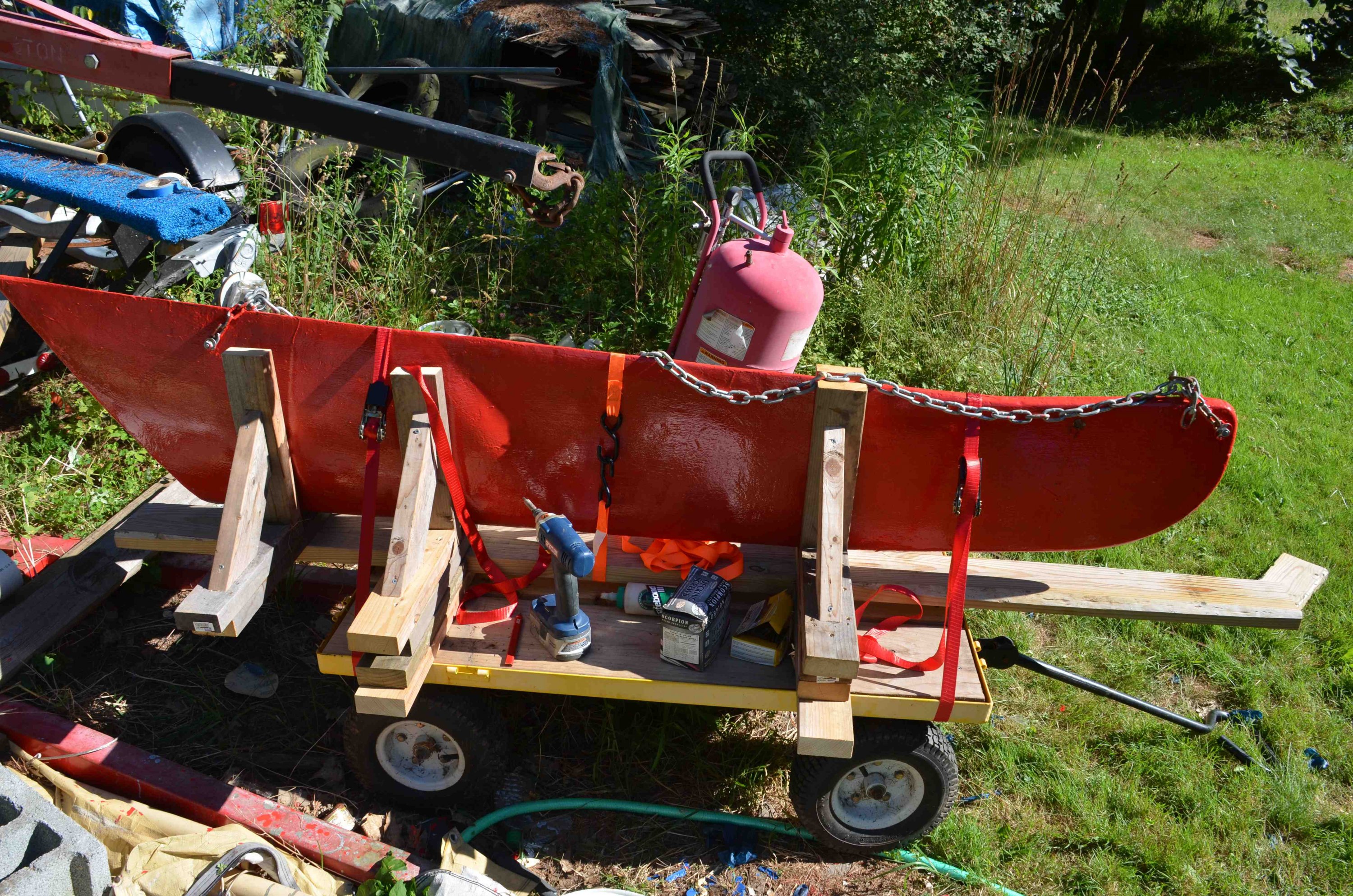

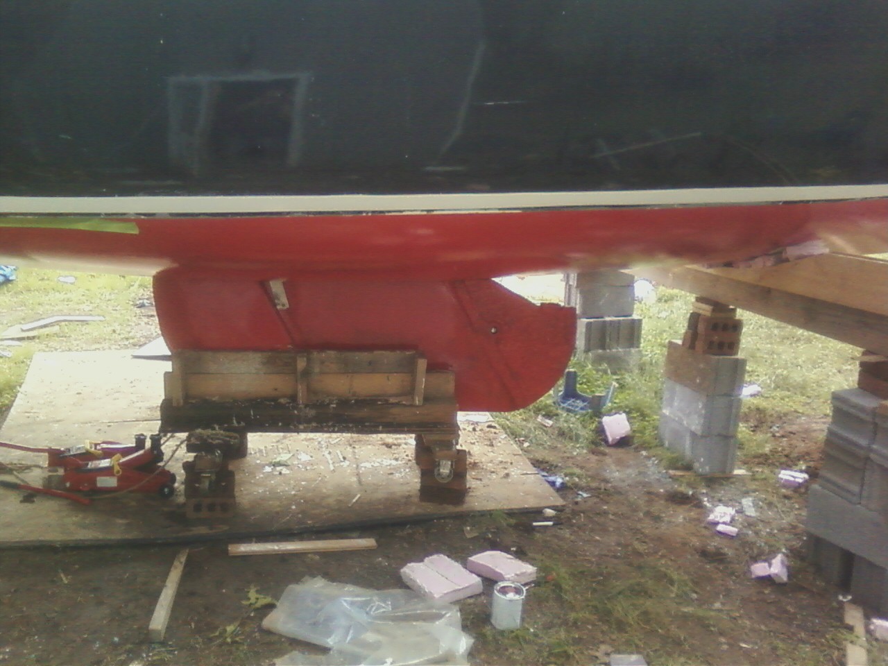

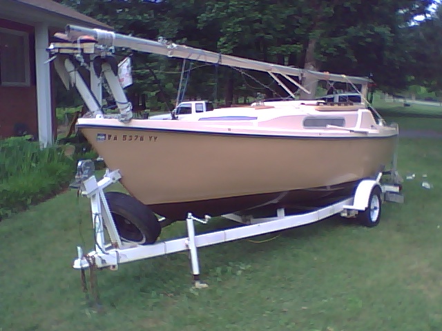

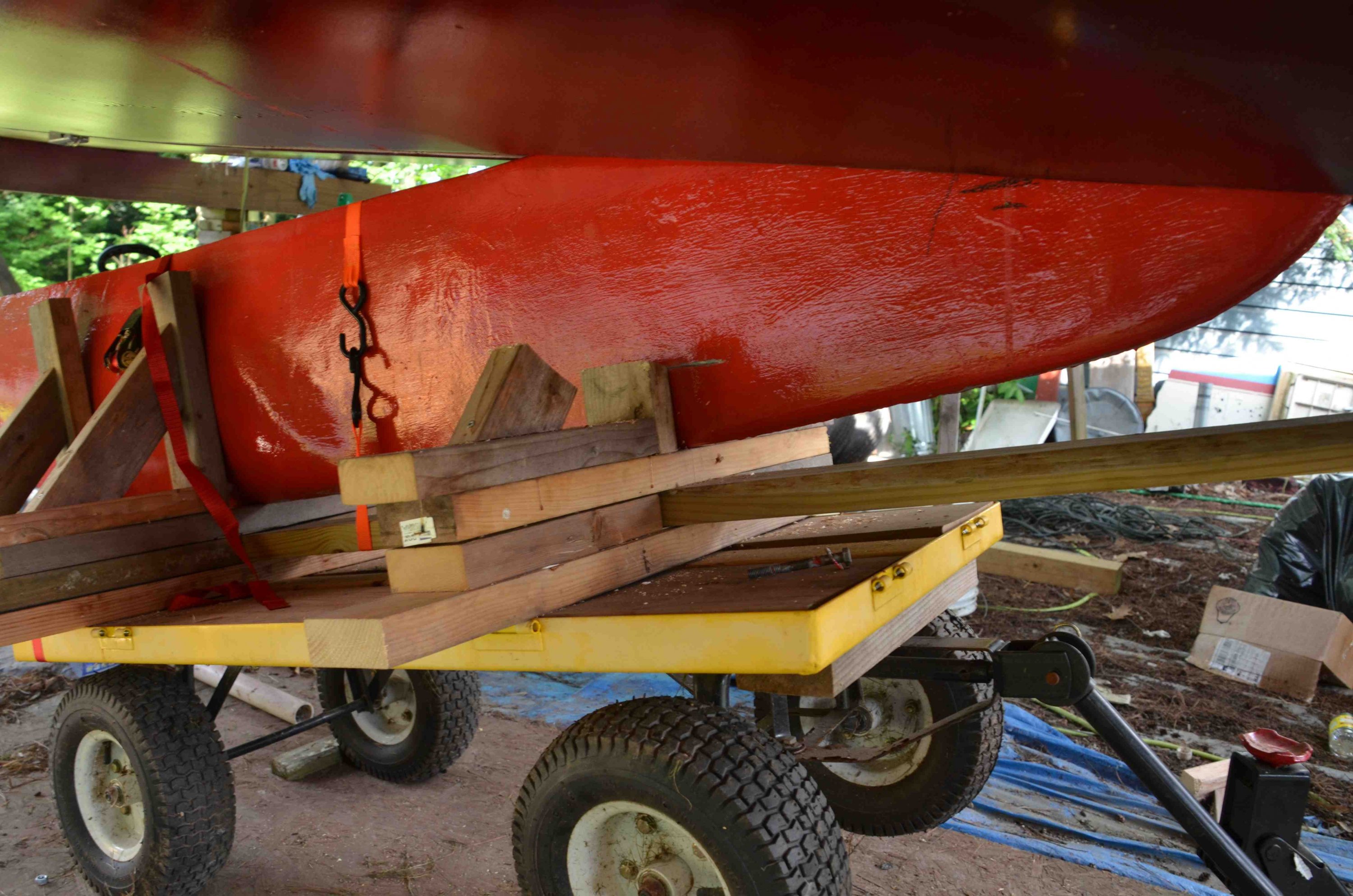

I have used regular old Rustoleum out of a can... rolled and tipped ... with great success. And the good part is... if you scrape the bottom of your boat two years later, you can find an exact color match. Each of these three boat's bottom was painted with Rustoleum.

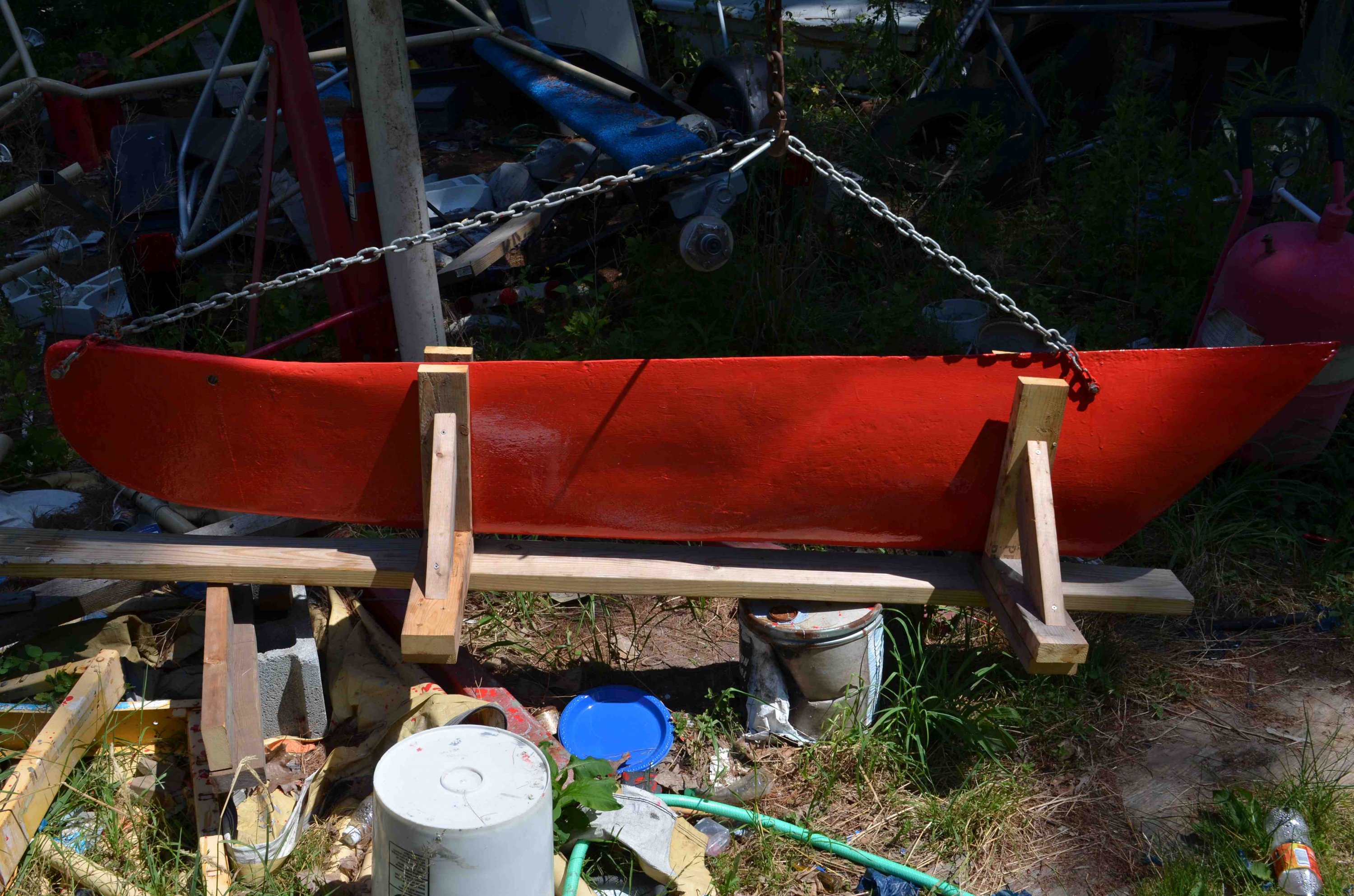

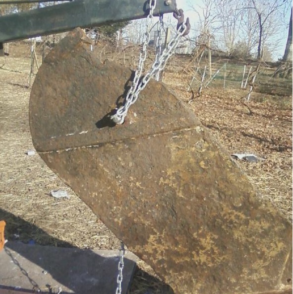

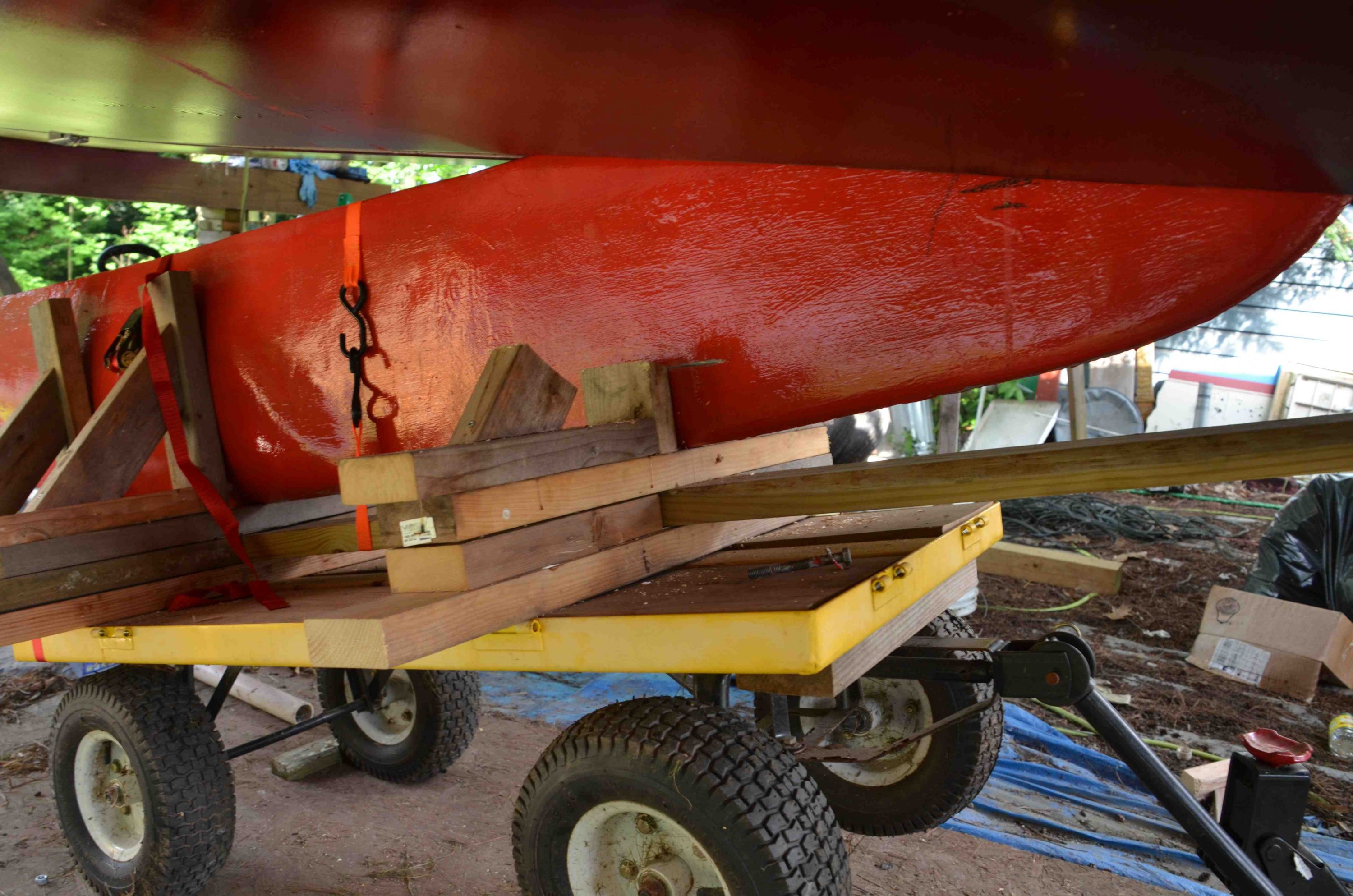

Naw! These boats had the ablative stuff on them... and I stripped the bottoms bare. I've been restoring old sailboats now for 14 years and I've learned (the hard way) that some people will hide damage to the hull under many many many layers of bottom paint. So the first thing I do is strip it all of (I even have a homemade recipe for peel away). Then I fill in any gouges, repair any cracks etc. and repaint. The keel you asked about was cast iron but I sandblasted, faired and covered it is several layers of epoxy barrier coat before I painted. The paint was just a way to make it match the bottom

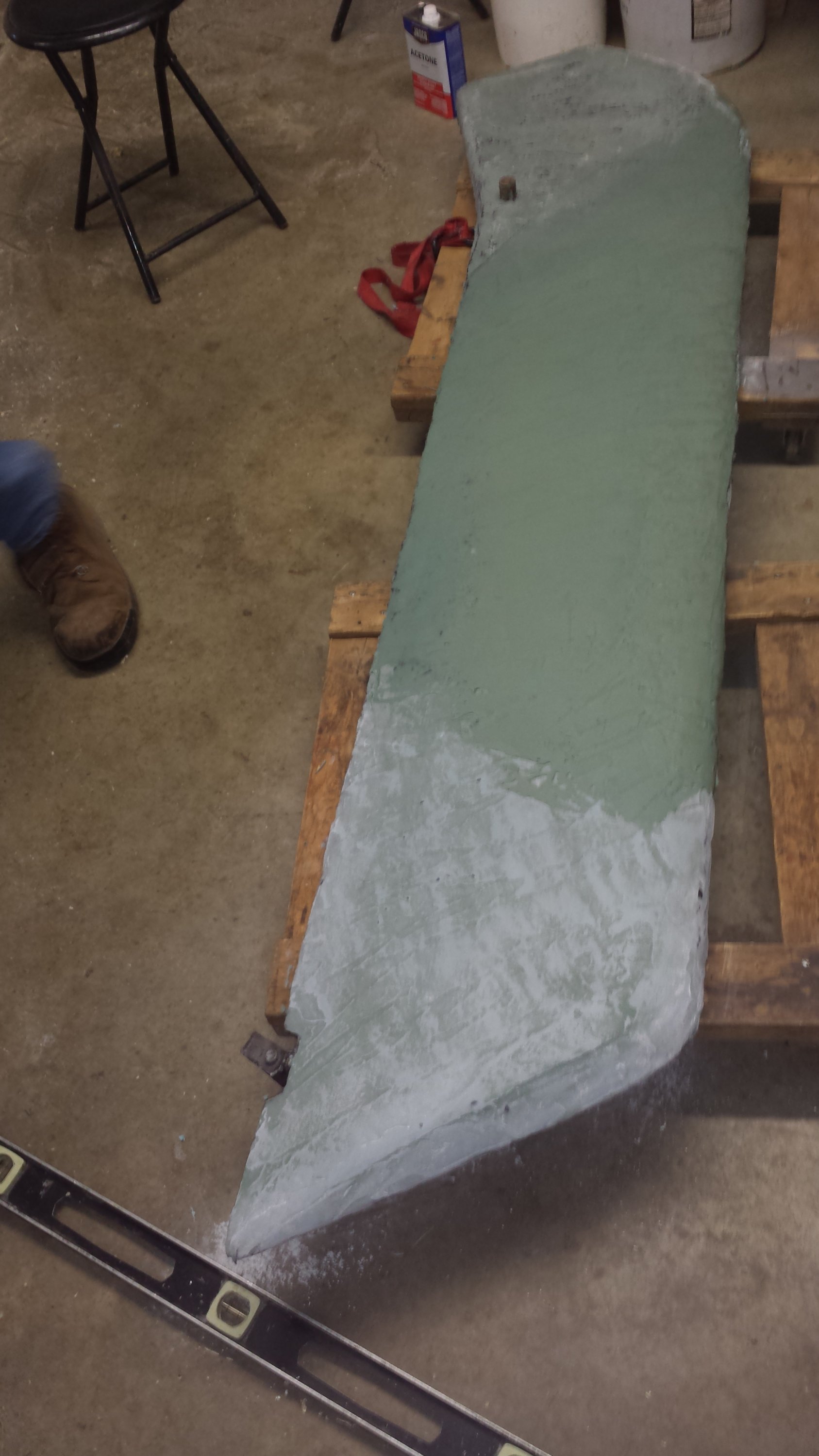

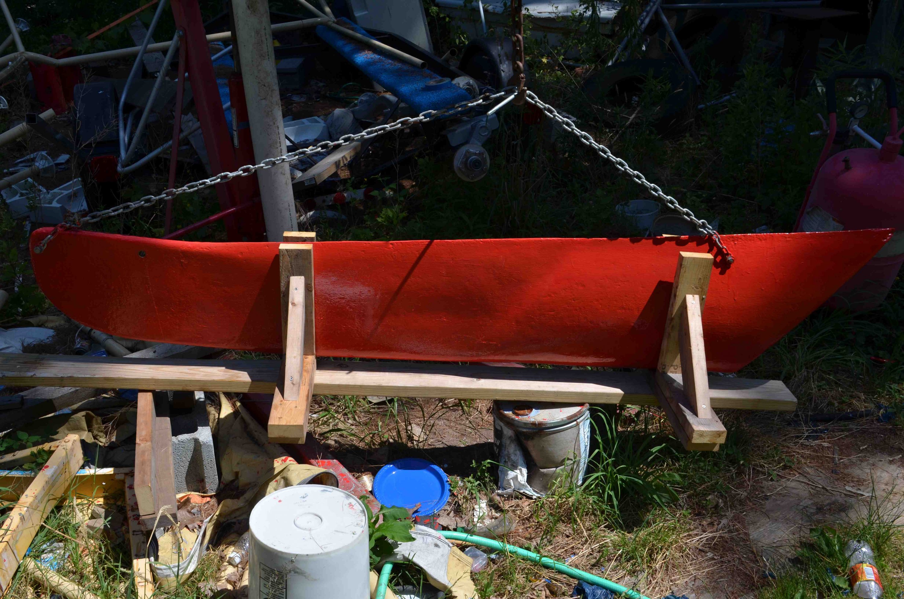

Here is the keel as of last weekend.

Thanks for the reply. I do have a cast iron swing keel that has been treated with Permatex rust treatment, then coated with Epoxy then fared with a fiberglass body filler. The ability to put the rustoleum directly on metal is long since past. The keel never had a gelcoat as far as I know.
I'm sure you will be perfectly fine for a drysailed boat. If you are sailing salt water, you should try and freshwater rinse the keel as you can. I don't know how that Permatex stuff works. The website says it "destroys rust" and then leaves a polymer coating. There's gotta be something in it to react with the iron oxide in order to "destroy" it. Maybe it has phosphoric acid after all?

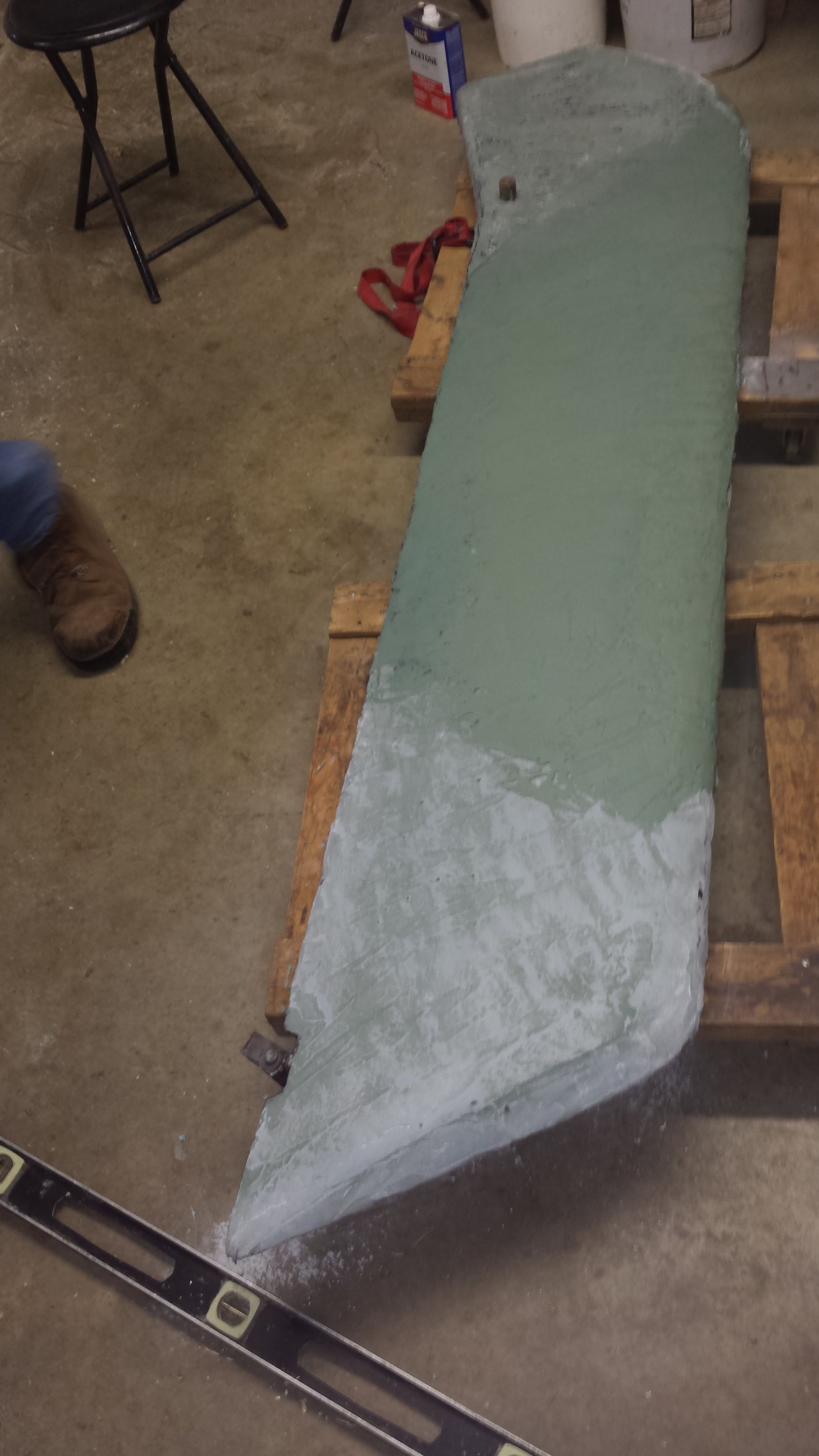

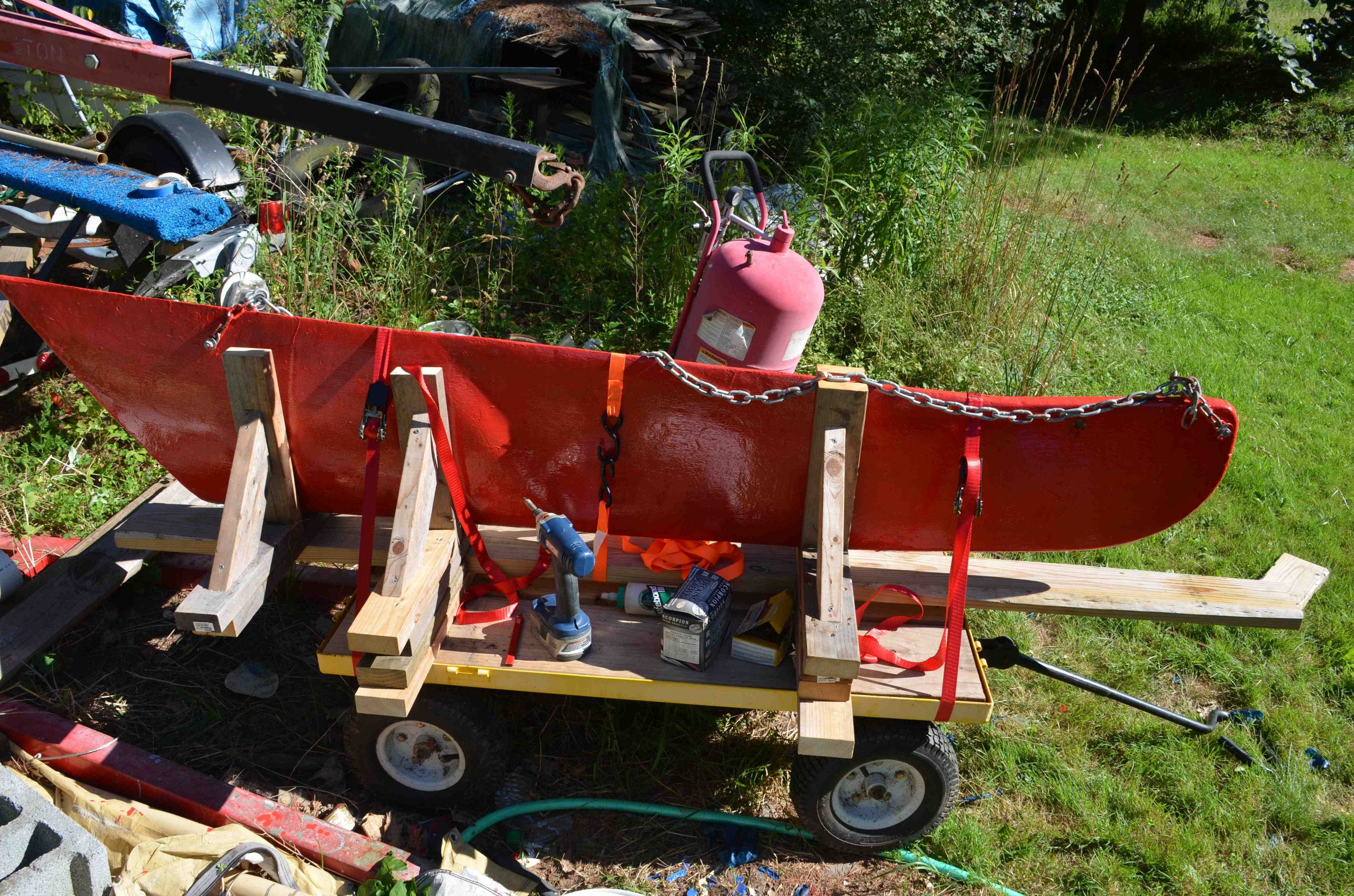

These are off of a Catalina... These were originally posted by a guy named Fred and I borrowed heavily from his ideas when doing my keel repair.
Haha, trying to steal my 15 seconds of fame huh? What is that off of? the shape is significantly different than mine. All these keels you do, you must be a man of patience. This is some serious work with some serious hours involved.
