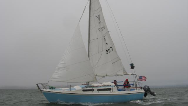

Here we are with it partially furled.
As for catching on the lifelines, you need to run the jib sheets outside the lifelines back to the cockpit. You should have a set of cars on the outside gunnale with a swivel padeye. Rund the lines outside through these and to your winches. If you are pointing the boat the right way, the sail will fill. One thing to caution you on, is that if you have it furled all the way out, and you have more than 12-15 mph wind, the genoa might backwind you main causing it to flap a bit. I sail a 25 with a 150% Genoa, on a furler, and I love it. I can pass 30 footers in SF Bay.
Keep the sail, and have fun with it.
