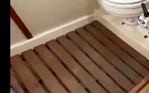

Why have a wooden floor mat in the head? Doesn't it make it much harder to keep clean and sanitary?

It looks like that is a grate designed to keep you off the floor and allow drainage under the feet. Our boat is designed this way with a teak grate. The head is also a shower and the grate allows water to drain while showering.
We find that removing the grate gives a little more headroom since it lowers the effective floor a couple of inches. But, the plain white gel coat is kind of stark, always dirty, and cold under bare feet at night.
I've never done anything in the head that made me concerned about a wood floor grate being unsanitary.

That is there as a floor for a shower. There should be a drain in the floor, and a sump below that with a pump that sends the shower water overboard or to a holding tank. Owners that "cheap out" on this system may let that drain directly into the bilge, which is often a source of an unpleasant smell from the bilge that owners seem unable to rid from the boat. Even if you don't use the shower, having a drain is great to wash down the head, especially if you have guys aboard who won't sit down to urinate.
I'd pull it up, clean it with the 2 part teak Snappy Teak-Nu Two Step Teak Cleaning Kit. Follow the directions and your teak will be more beautiful than you could have imagined.

Is that a wet shower? It looks like water could drain down to a sump to be pumped out to the bilge or out of a through hull.

Yes it is a wet shower. Even without the wood floor the water would drain down to a sump, probably a lot easier and a lot more complete.
