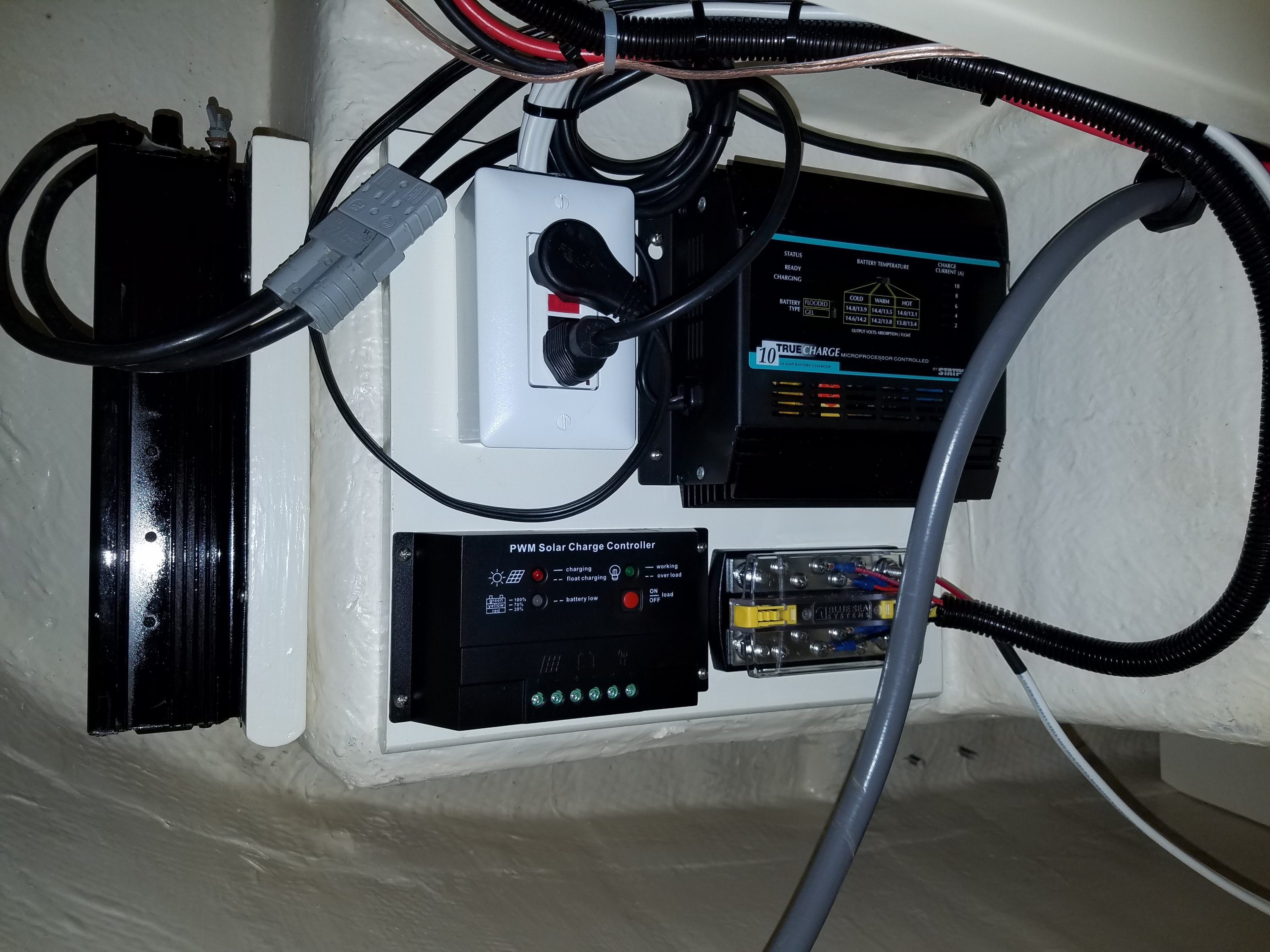

Very Interested in this post as I have a new to me H260 and 2 GC 6volts that I just pulled out of my Mac 26, I have 2 x 12v at the moment one under the sink and one behind the rear berth, Id like to put the GCs both under the sink as they weigh a ton, and sell the 2 x 12vs with the Mac.
I run a 12v RV water pump to the two faucets and would like to add the Keurig feature through my inverter.
At the moment I keep it charged with a 30 watt solar panel but imagine I will have to really beef this up in the future.
Ive also found one of those 12v digital starters are worth their weight in gold when the starter battery runs down and you don't have a pull cord feature.
Can you post some pics on here once you get it completed.

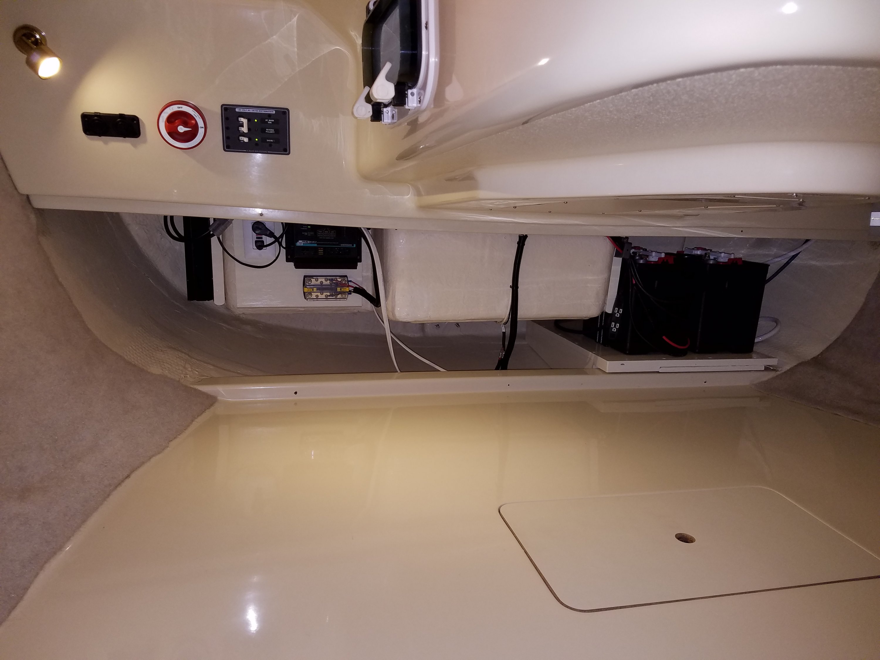

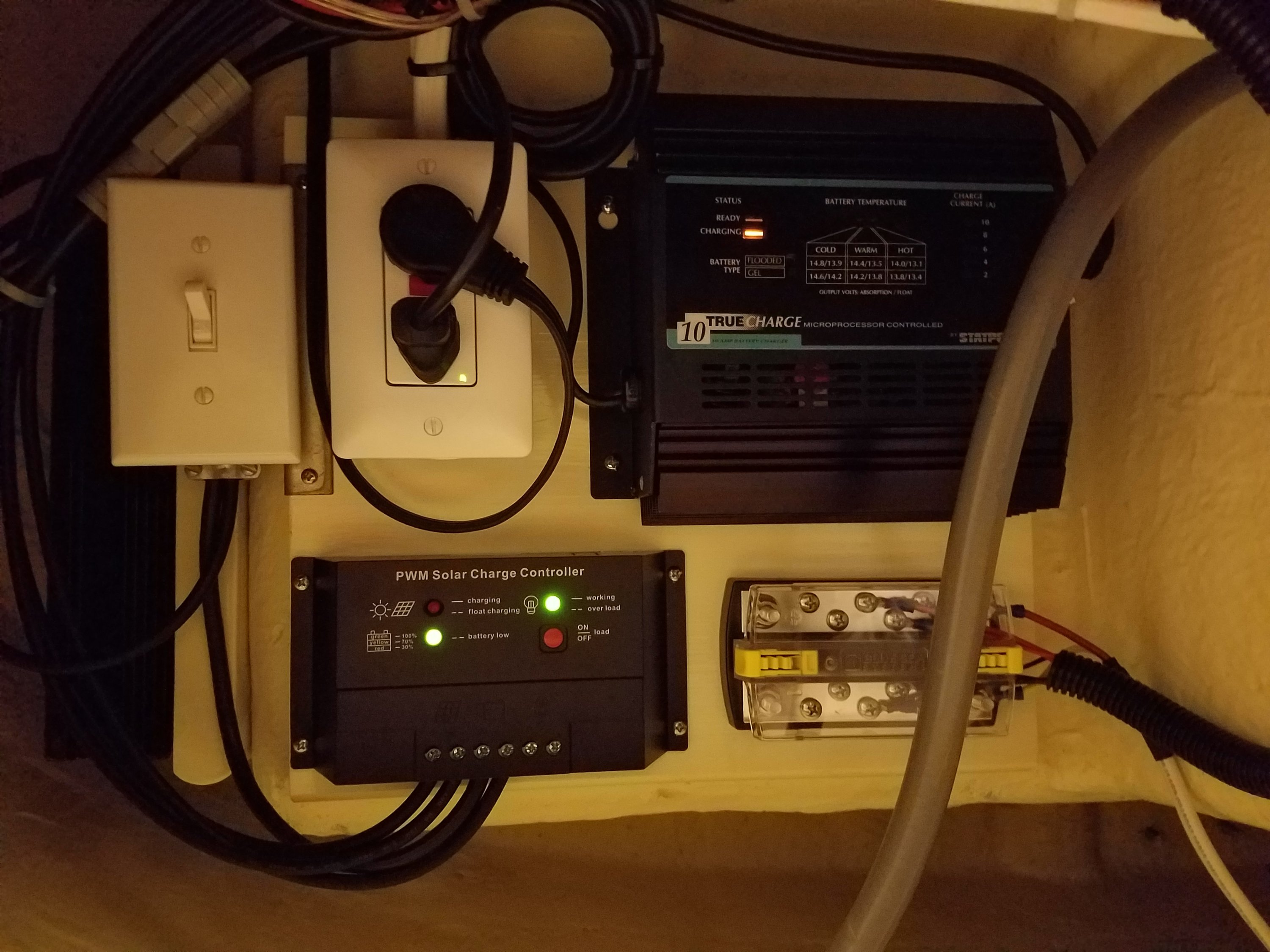

Tyler I did exactly what you are describing to my 26.
Here's a link to my mod in the mod section.
https://hunter.sailboatowners.com/mods.php?task=article&mid=15&aid=100055&mn=26

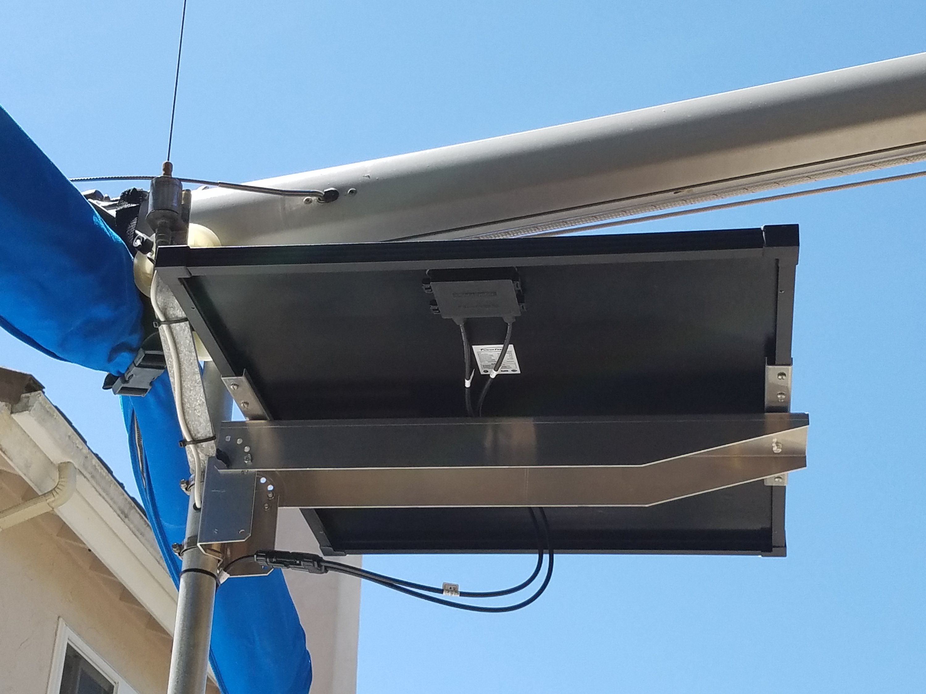

I have since added an 80 watt solar panel with charge controller. I have an 1800 watt inverter that came with the boat, but haven't really used it, tested it, but that's all. I do have a small 300 watt inverter that is plenty to power my 19" LED TV/DVD combo. I have a simple on/off battery switch. My 15HP Merc does not have electric start, wish it did.
I have pressure water, all LED lights, auto-helm, sound system, etc.
https://hunter.sailboatowners.com/mods.php?task=article&mid=15&aid=100074&mn=26

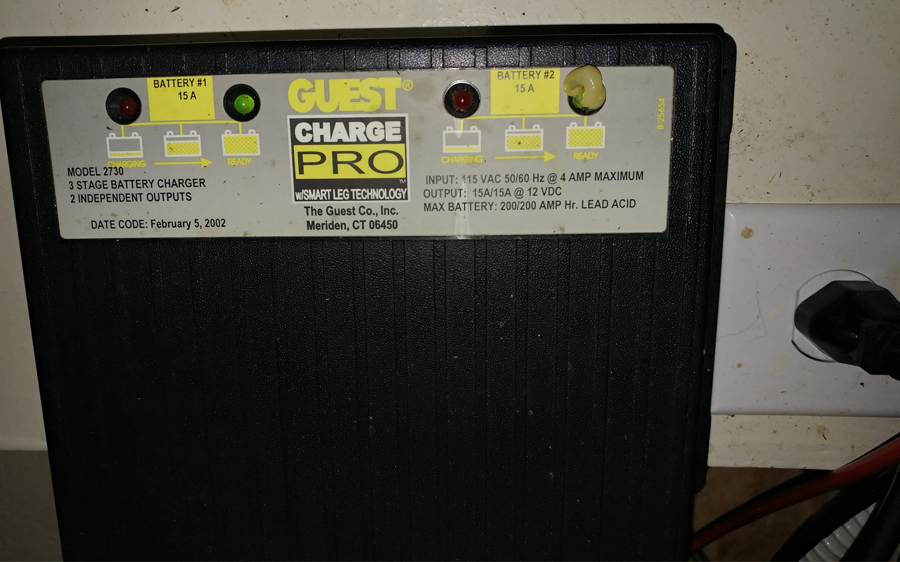

Ok, this is what I have currently. Looks like I may be on the edge as far as the charger is concerned for the 2 GC2 batteries in series?
Should work fine! Also known as a Smart Charger. Stage 1 Initial bulk charge, Stage 2 starts to reduce amps, Stage 3 float to maintain 100% charge. Safe to leave at float for long periods of time.

Looking at your charger pic, what the heck is going on with the #2 full led?? Looks like a worm is crawling out of it.

the charger is not the best available, but its a lot better than some use... its totally acceptable for your use, but if you had multiple batteries in a series-parallel bank, then you may want something different.
I would be happy with it, as it has 2 legs of 12v @15amp each... it will take care of the batteries in a better manner than your habits of using them will...
but its your money and it needs to be spent on something, and a premium, top of the line charger is never overkill ;-)

Ha! Yes I see it, but have no idea. It's dark back there and I shoved my phone in with the flash on. I will see if it's a drop of sealant/adhesive or what in the next couple days.
Centerline, that's how I was feeling (that is is likely decent enough for my use) and I'm glad to hear that it's yours as well. I have plenty of other expensive things to purchase, don't worry!
