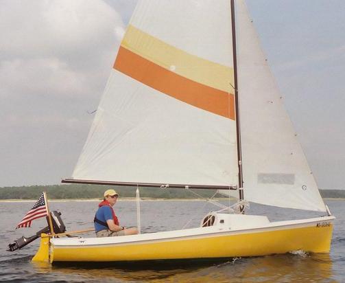

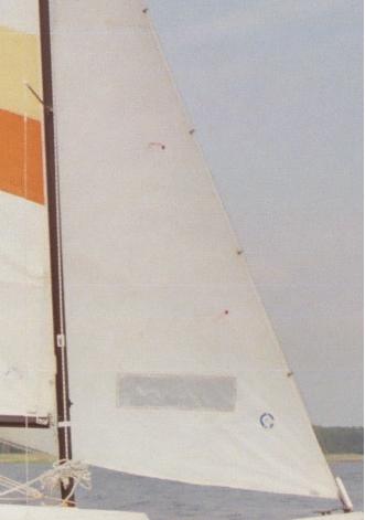

On my DS II (same jib, theoretically) the bottom hank is about 18" or so up from the tack, the top hank is about 6" or so down from the head, and there are a total of 6 hanks (roughly equally spaced). The standard DS jib has a 15' luff, so the hanks will be about 2.5' apart (seems wide spacing, but I'm estimating from memory and a picture of my boat) I'd check my jib but it is stored at our cottage 40 miles from my home (as is the boat). I used to keep my sails in my home attic for the winter..... too bad I stopped doing that!
I've included a close-up of the jib from the picture that I made my estimates with, too bad you can't see the top hank.... well, it should still help! I also included the whole pic, do I look relaxed? Maybe I'm trying to ignore the powerboater (my Dad) trying to take the picture?

I had a chance to check my Jib today, for reference the hanks are spaced 29" apart, with the lowest one 29" up the luff from the tack and the top one approximately 3" from the head.
