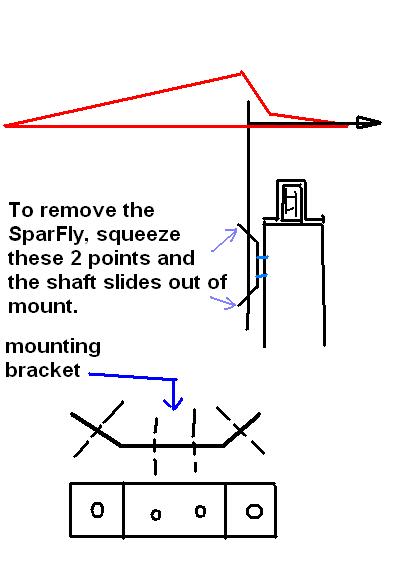

You could mount either a Davis Spar-Fly http://www.davisnet.com/marine/products/marine_product.asp?pnum=01310 or a Davis Windex 10 Sport http://www.davisnet.com/marine/products/marine_product.asp?pnum=03120 on the masthead. On my Harpoon, I have the bracket for a Spar-Fly screwed into the side of the top of the mast, and also a socket for the Windex 10 Sport on top of the masthead fitting. Currently, both devices are broken and not installed. Guess I need to get one, though I just got 2nd in a distance race without!
