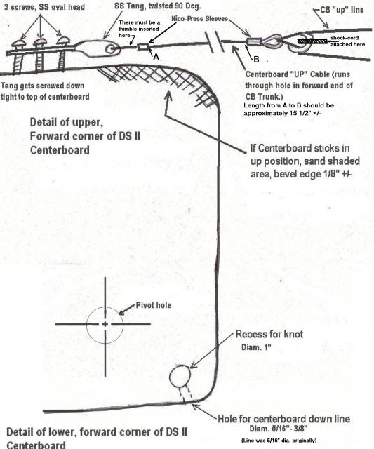

OK, let me backtrack a bit....... (I got ahead of myself!) First, yo usay the CB is stuck in the up position. When you dove under the boat, could you free the CB? I had to use gentle persuasion with a small pry bar the first couple times this happened. If you were able to get the CB to come down by wiggling/prying from below..... and if the lines/cables weren't jamming it, then I suspect that you have a CB like mine.... top forward corner of the CB is squared off..... inside of CB trunk is rounded, CB jams. I had to remove the CB and sand/grind the edges a bit to round them over.... CB is now less likely to jam. Next, it is possible that you are getting a vacuum forming in the trunk due to air not being able to get in to break it. The line that is attached to the CB to lower it (that is pull it down) is a 5/16" 3-strand line and that is a slightly tight fit through the "donut" in the CB trunk, try carefully prying the donut up and out (temporarily) that may let in a bit of air and allow the CB to drop easier. You say the line is "frayed", when you remove the CB to sand the upper corner, replace that down line with a length of 1/4" double-braid polyester line (about 30" long) the slightly smaller diameter will allow more air in around the opening. Finally, there may be some kind of dirt / debris / growth that has jammed the CB.

Thanks for the info. The boat is a '77 and had the nylon bushings around the centerboard bolt. I hauled it over by the jib halyard, wiggled it back and forth a little in the sand to make a wider area taking the load, and then tied the mast to a dock. It turns out there was a ton of debris in the recess for the centerboard, and some was keeping the rope from going through the hole toward the pulley. I removed the two broken strands of rope, left the third and final intact, and it works fine now. I had planned to replace the rope, but the recess made for the knot had been filled with epoxy or something. I didn't have the tools with me at the time to dig it out, and the centerboard is functional now, so it can wait until another day.
Do you use a resin or epoxy to fill this recess? If so, what do you use?

Actually, I just left the knot exposed, didn't really need the filler I figured. My knot tucked in pretty well. The stuff chipped out pretty easy with a small chisel as I recall. If last strand did break all it really means is that you can't "lock" the CB down, mine will drop without pulling the line usually.... might not go "full" down..... but it does drop.
