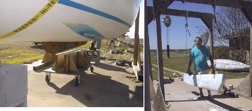

I did pretty much the same as Dan McGuire did on my 82 MacGregor 23. The first order of business is to lift the boat off of the trailer. There have been several ways described by others, but I build a couple of “gallowses” out of 4x4. They have worked well for keel work and bottom refinishing. I then rolled my home made dolly under the keel. I placed an automobile jack right under the keelbolt and lifted just enough to take the pressure off. My bolt then slid out easily. Drop the keel into the dolly by alternately lowering the jack and then cranking down a couple of turns on the winch until the keel rests on the dolly. Don’t ever try to man-handle the thing – you will wind up with something crushed or missing. When I got the keel loose and ready to refinish, I first tried wire brushing the rust off, but gave that up after a couple of hours of blood and sweat. A trip over to the sandblaster solved the problem nicely. Hope this helps, Keith Brglund 82 Mac 23 #1582 "Fullwave"

What kind of straps did you use on your boat-gallows?

The straps I used were trucker’s straps straight from Home Depot. They are about 2.5 inches wide and rated for 10,000 Lbs. As the boat only weighs 2,500 Lbs., I’m good to go. One bad thing is that they will ratchet “UP” but not down. I painted the keel using Interlux products with good results. They recommend that you paint the keel within one hour of the sand-blasting. As soon as I got home from the sand-blasters I painted it with a two part 2001/2002 epoxy. After the first coat dried, I fared the now exposed casting pits with an Interlux underwater filler. After sanding that smooth, I applied three more coats of epoxy paint and a couple of coats of antifouling paint. Two years later, the keel still looks good except for a couple of dings on the bottom and leading edge where it has met objects more resistant than itself. I can easily touch-up these areas with the boat still on the trailer. Keith Berglund 82 Mac 23 #1582 “Fullwave”
