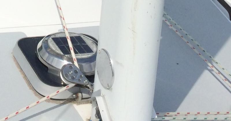

Do as HogHaven suggested by removing the sheave or making an access hole, then using a electricians tape to pull the wire back up to the light. The steaming light wire is most likely dropped down in the mast. It can't really drop down into the compression post or bilge due to the disconnect plug at the base of the mast. I put in a access hole big enough for my hand to fit in about 8" up off the deck. Makes getting to those plugs easy.
dj2210
Feb 4, 2012
337
Catalina 30 Watts Bar
Access Hole- sorry but best picture I got of it. You can just see it at the bottom of the mast with a round aluminum plate. Its held on with four screws

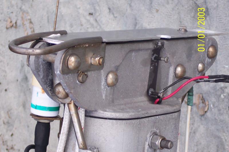

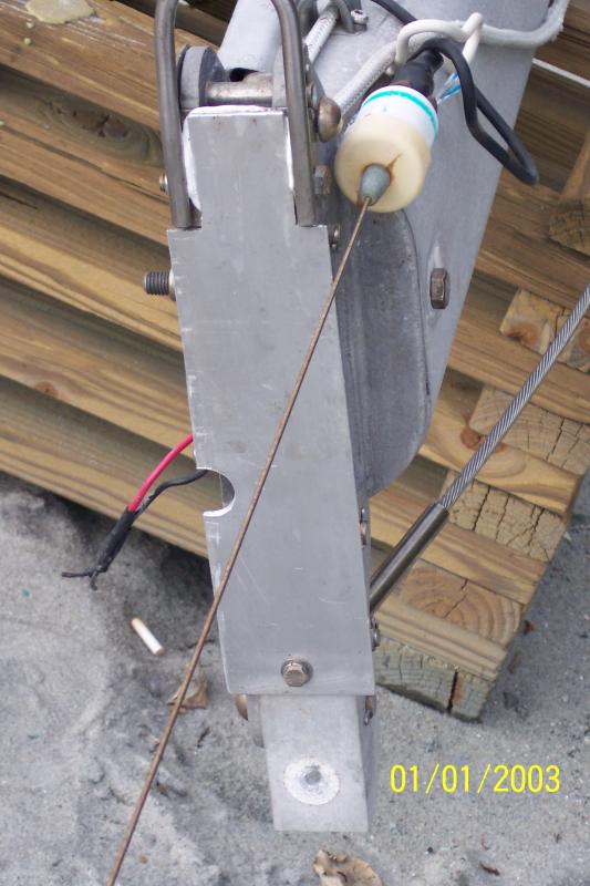

Because I had an open crane at the top of my mast & had problems with a wet core at the base, I made a close-off plate over the crane (top pulleys) fixed the deck & cut two round holes near the base, one SYBD & port.
This does two things, one for venting/drying water at the base & it gives me access. I bought two S.S. louvered vents at Waste Marine. I can remove this for inspection etc. I believe my holes are 4" dia. You may not want two holes but it gives cross ventilation. Plus, there is more light if needing to do some work & allows for a flashlight opposite the side you are working from if needing more light. Look closely at the mast.
Here's a view of what I did for a close-off plate & my vents for reference.
