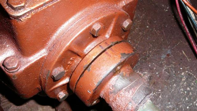

There 'should' be a dimple in the shaft for the set screw...the set screw(bolt) 'should' also have a hole drilled in it, so that you can wire it around the shaft half of the coupler so it has no chance to back out.
I replaced everything from and including the rear main seal aft this summer when I wish I'd been sailing..at any rate..here is a pic of the new parts...the piece I am missing in the 'after pic' is one you may have been missing as well..the safety wire..it should be wrapped around the coupler..In the 'before pic', you can see the safety wire still in place, but the coupler unbolted from the engine.
