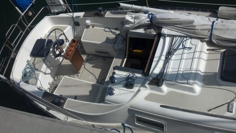

Here is a photo of the deck layout of my 1980 H30. The organizer, far right, is not thru bolted, but rather is bolted into the aluminum plate embedded in the deck. The mounting is very solid. Likewise the stoppers are bolted to the aluminum plate, as is the winch closest to the hatch. The more outboard winch, which was installed by a prior owner (and which serves no useful purpose as far as I can tell), is thru-bolted. So, you can drill and tap, or thru-bolt, whatever floats your boat, so to speak.
A downside to drilling and tapping as I see it is that you have stainless bolts threaded into aluminum, so there is potential for corrosion. I use plenty of Tuff-gel on the bolt threads and bed the fittings with butyl tape so hopefully this won't be an issue. Even thru-bolting, some Tuff-gel would probably be a good idea.
