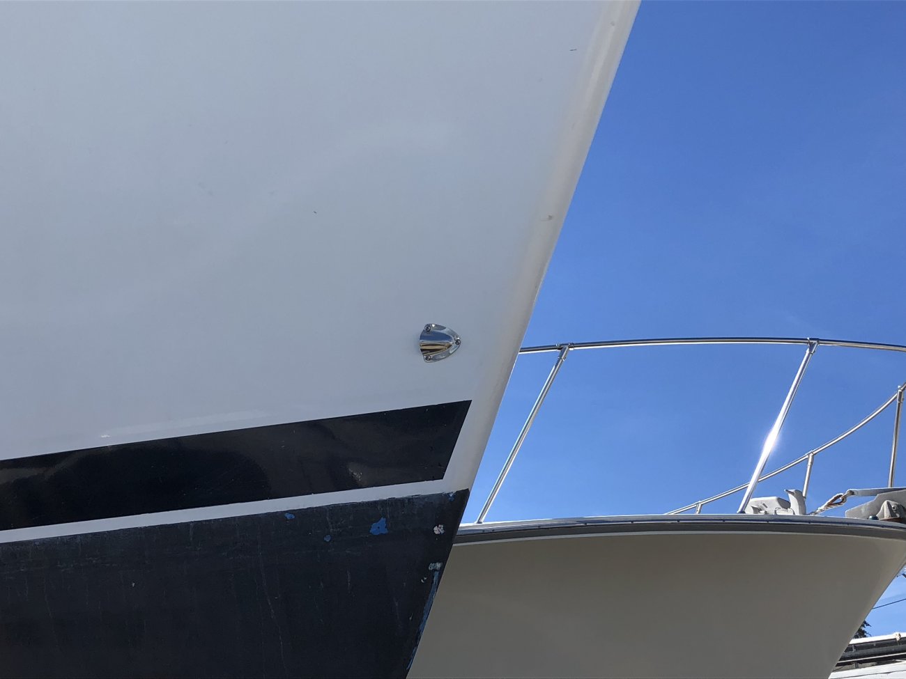

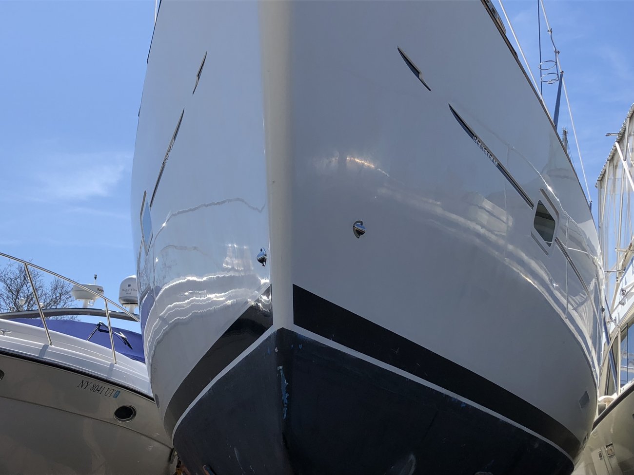

Well drilled the holes 1.5 inch fiberglass so only went in 1/4 inch. Drilled counter sunk, little butyl on each hole. Came out great. Thanks for advise....
