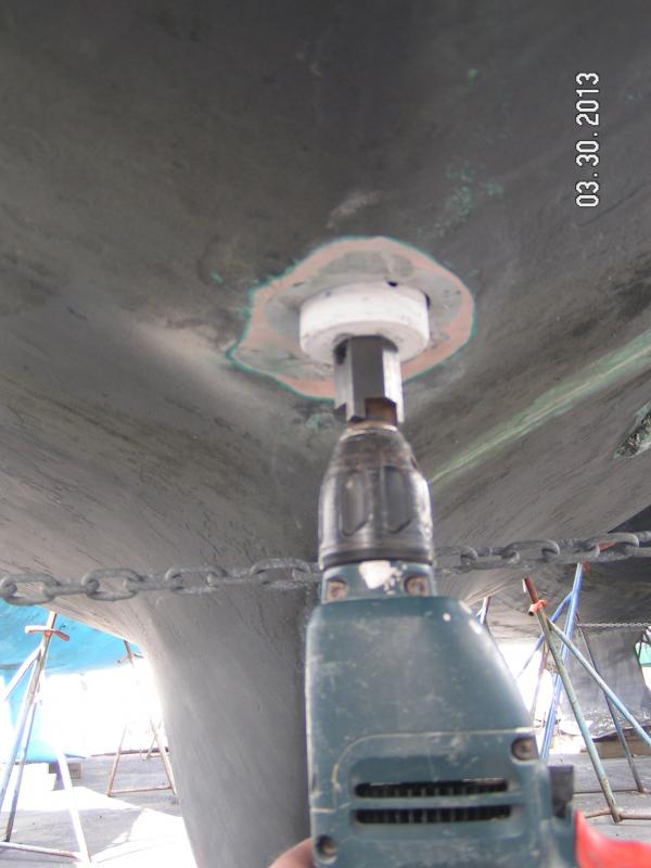

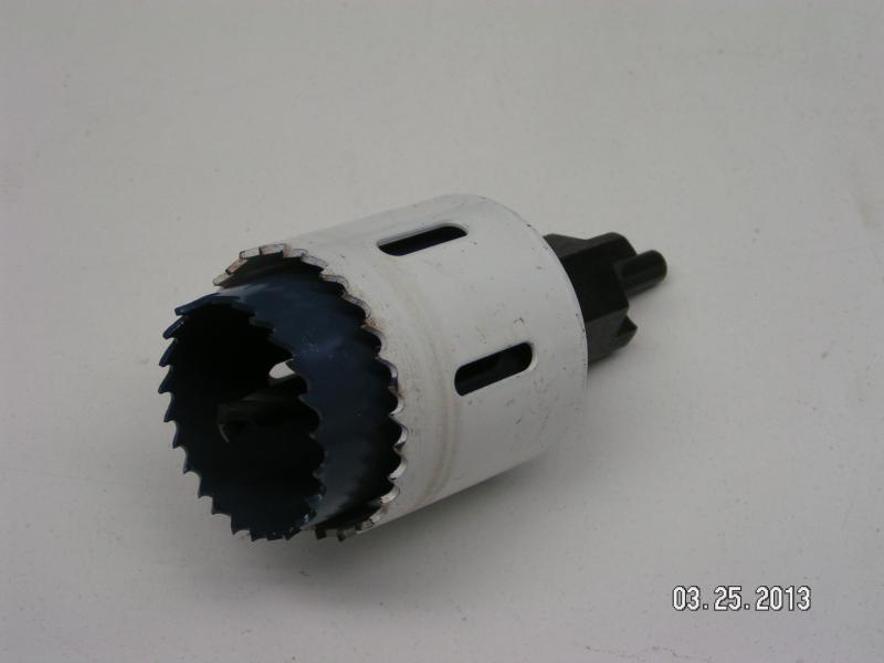

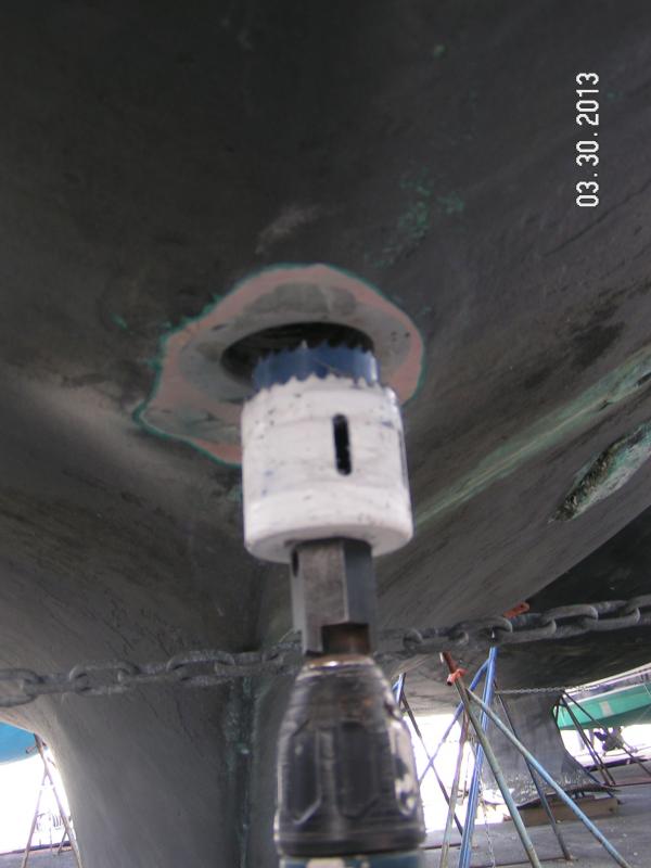

If you have a hole saw that matches the original hole size, then just stack the smaller saw and the new larger saw together.
The smaller saw will seat in the original hole and keep the larger saw steady.
I've done this before without issue.

I did just that with 2 concentric hole saw cutters inserted into each other. Make a test cut on another starboard to make sure the device will fit properly. After you make the cut be sure to coat the newly cut surface with 3 coats of epoxy to prevent any water penetration into the hull material. Let it dry then use 3M 4200 quick dry before inserting the device. It does not take much tightening from the other side.
