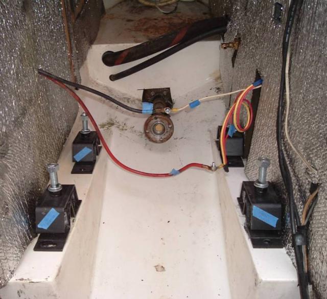

The 33 pan must be different. On the 37C it would spill over the front before it would back up to the hole under the stuffing box. . . .maybe. For those of you with leaks you can keep something there to soak up the oil/diesel. The pads made for that are kind of expensive. Someone offered up a cheaper solution but I forget what. I like to keep my engine pan looking like the picture.

Wow, is all I can say. There is a lot going on in the old 33 in the engine head/shower area. Please bear with me on a run through of what is found back there. This will echo a lot of what has already been said and add something too. First the drain for the stuffing box goes under the engine sump. This drain can and does plug up with dirt. About twice a year it has to be cleaned out with a long rod or similar tool. Next, the sump under the engine is a dead end except that it is open in the back. This is to catch oil from the engine and should be cleaned manually. Never drill a hole to let this sump open. third, there is a shower sump ahead of the engine sump. This sump is drained with a bilge pump a switch for it is on the wall of the head. The hole in the head floor leads to the shower sump. And fourth, there is a compartment in back of the head accessed through the lazzarette that holds the water pump and water hoses. This compartment will drain through the head if it contains water.
