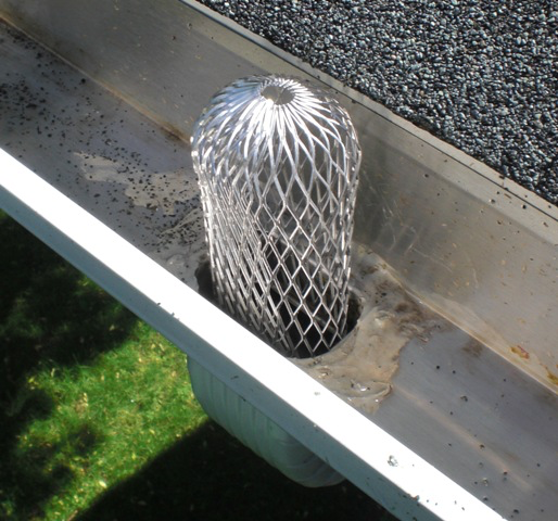

I have used these in my gutters to help.
Available at your friendly hardware or box store. Made of aluminum so as not to rust. They eventually get clogged. It will get you to check on the boat occasionally, but will allow you a few days away.
