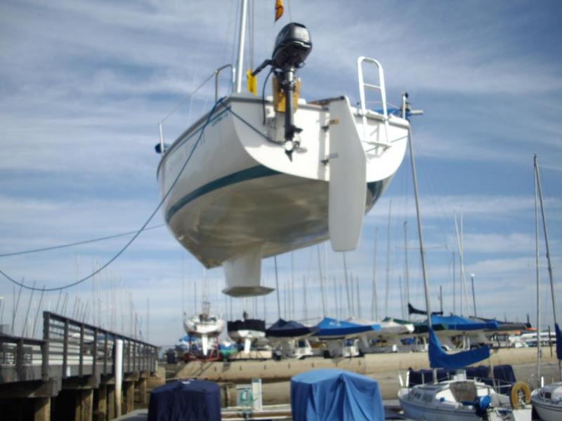

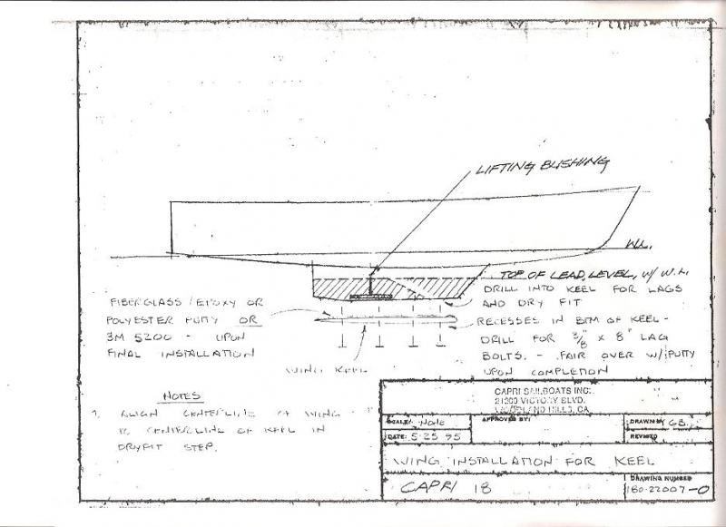

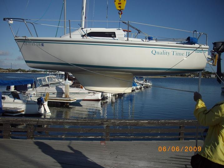

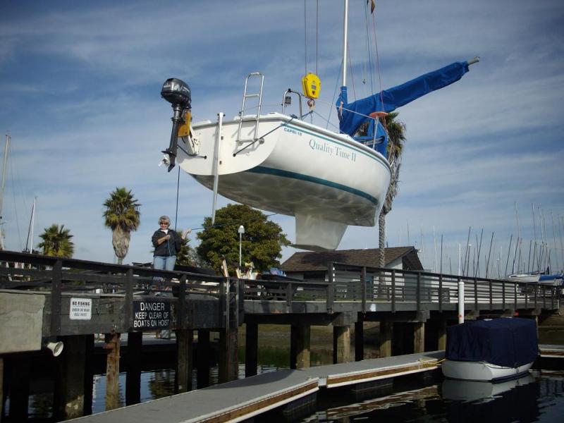

Steve, Given a choice, I would go with the wing version. Lot's of opinions, but I believe to wing helps to keep the water flow over the keel, like winglet's on aircraft. A couple inches shouldn't make that big of a difference, and I haven't had the issues folks talk about when running aground, that the wing will dig into the bottom like a Danforth anchor and cause issues to get free, but then again, I don't run aground, so what would I know....
