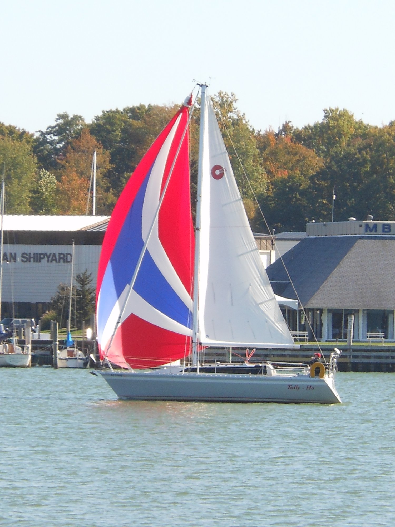

I tack my A-spin off on my bow roller. No sprit needed.
You don’t have to use the main if you think it will blanket the head sail.
Neither an A-spin nor a B&R rig (due to the swept back spreaders) are great dead down wind.
But you can sail near DDW…

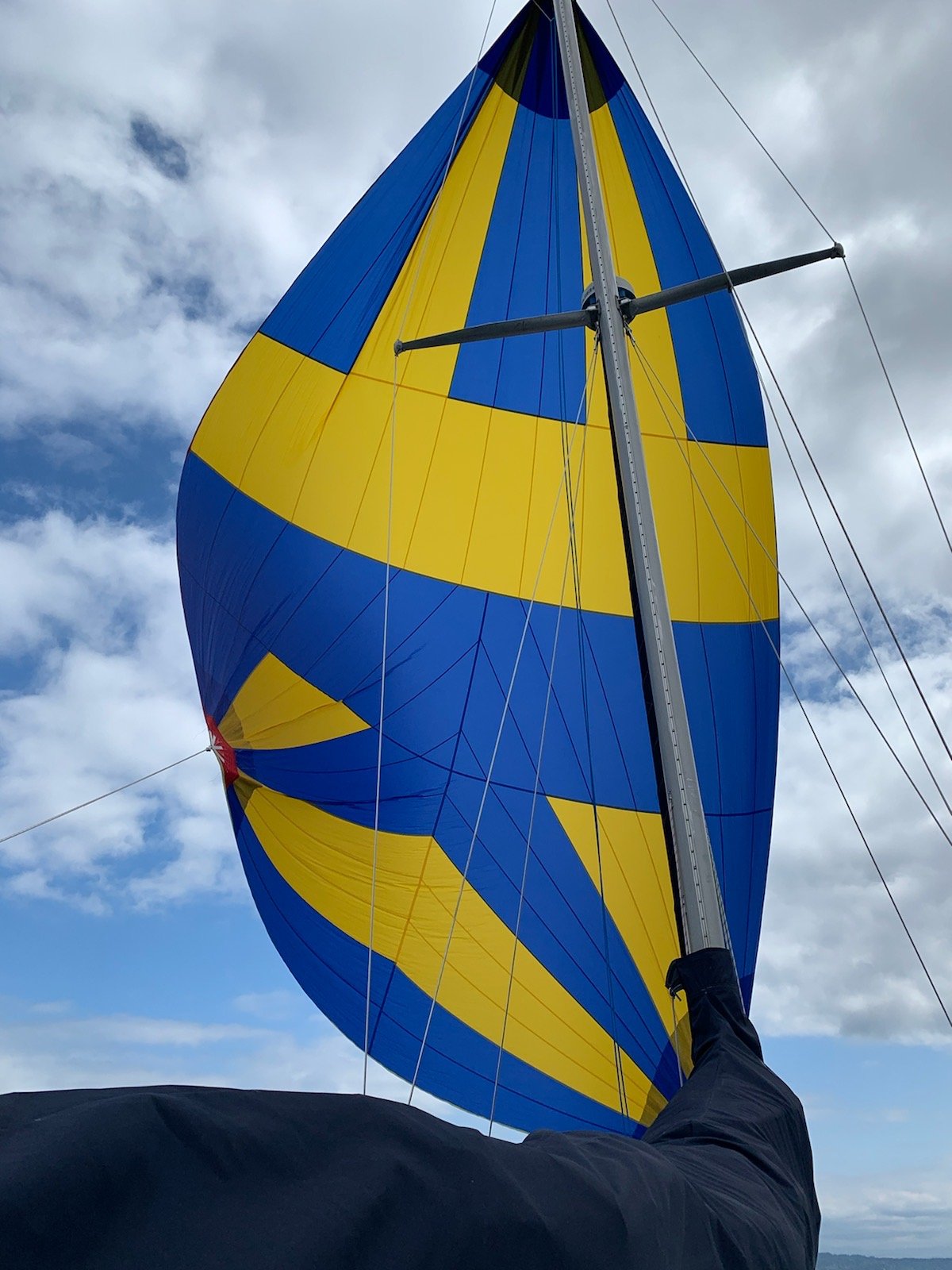

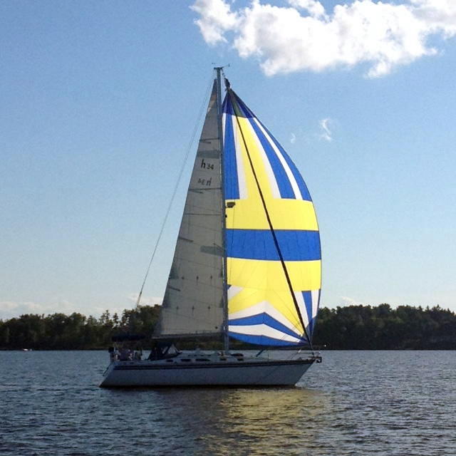

As Jssailem and Tally-Ho said, an A-sym tacked on the bow (like Tally-Ho I tack mine to the bow roller) is easily flown ahead of the head-stay. You're not going to sail DDW with the A-sym, but gybing with the A-sym in front of the furled headsail is not hard to do. Full main should not be a peoblem when on a beam reach (See pix). If the wind moves aft and the angle is such that the main partially blocks the wind from reaching the A-sym, I have had success minimizing that by taking a reef. FYI, my A-sym has a sock and I sail solo most of the time.

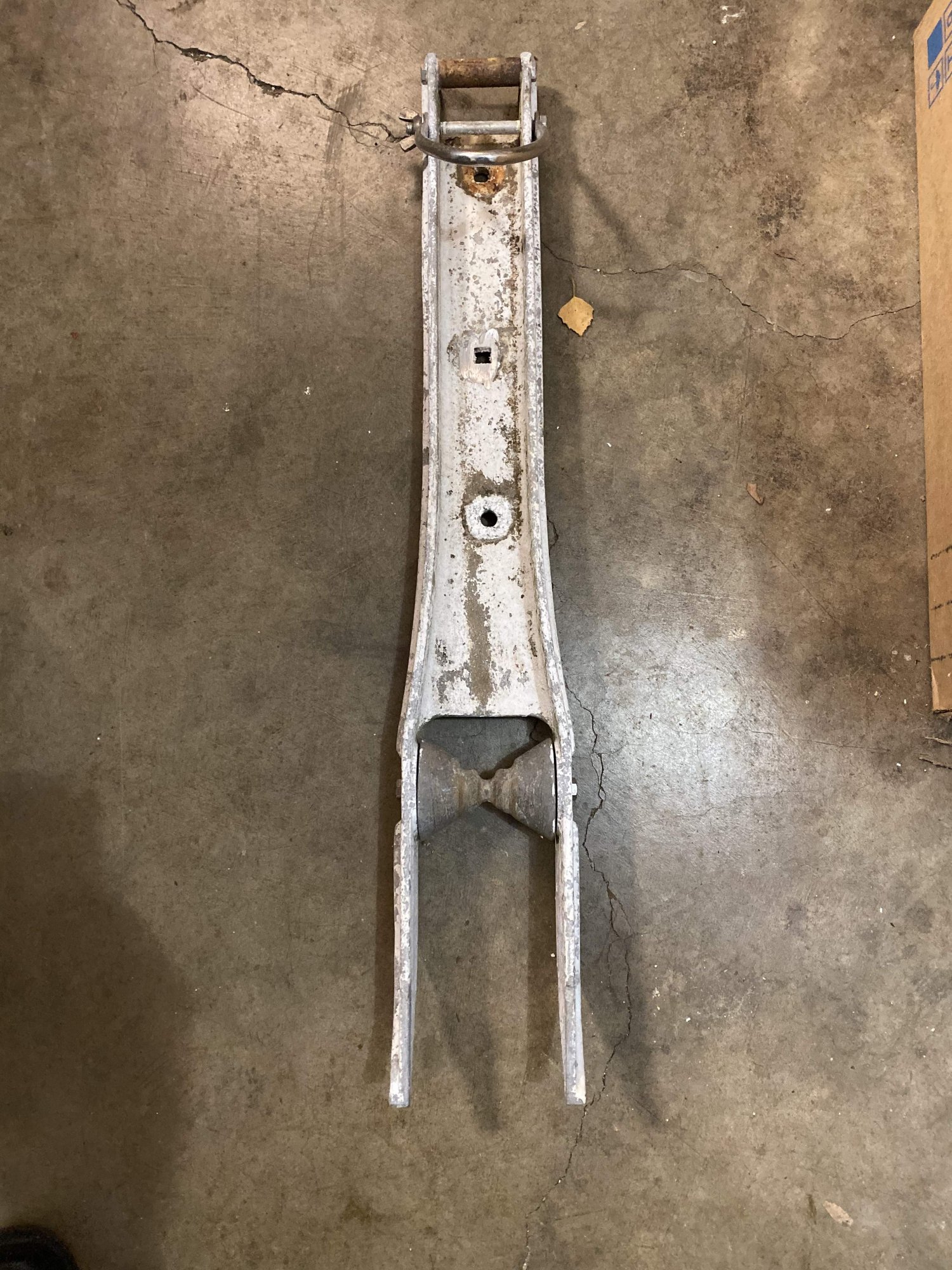

I thought about converting to a top down furler but was told that i need at the very least 6" of separation between the furler torsion line and the headsail furler foil and that 9" or more would be much better. I can only get about 3" with the sail on the anchor roller on my tall/rig bow sprit so that means that I would also need to get an extending bow sprit which would about double the cost of the setup.
Likes: Diablito
23,390
I have an old bow roller that could get you the additional 3"s you need...
Think of it as viagra for a sail boat.
