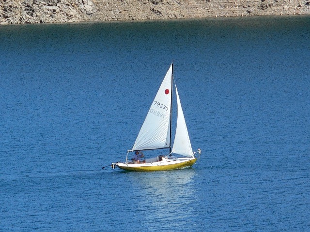

We took Tweety (Victoria 18) to a small local lake yesterday for some AM (calm) fishing and PM sailing. in between, I had a bit too much time to contemplate, and discovered all sorts of things that I didn't know I didn't understand. For one, I must be missing something in the translation when it comes to tightening the luff of the main, to attain a nice smooth sail. to me, the halyard, downhaul and cunningham all do pretty much the same thing, except that the halyard tightens from the top and the other two from the bottom. 6 of one = 1/2 dozen of the other, but they all tighten the luff. when would one be used over the other and why?
