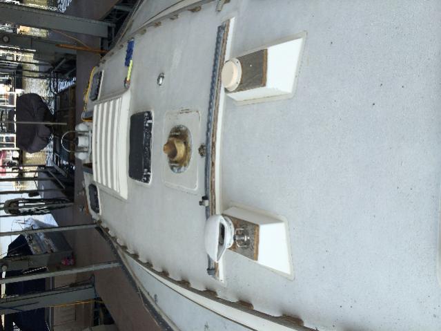

On Drifter 1980 37' which I have been restoring. .. This is what I have. Either Dorade box I feel should have a hole in it at deck level to let water out? Should there be two horns. ..? Can one buy more of these type horns that match the oem? Mucho appreciated!

On my '83 H37C each dorade box has a hole at the bottom on the outboard side.
The dorades are a standard size and can be replaced.
If you are really pounding into big waves and wind you better turn them toward the stern or the spray will be blasted into the interior - I found out the hard way.

How big of a hole?
Where on the outboard side?
My fiberglass guy must have filled them them in...
