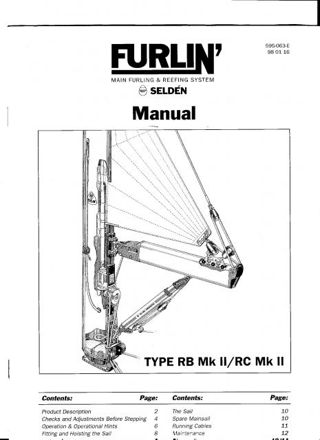

I have a 1999 furlex on my boat (Hunter 410)-- I will try to scan the set up diagrams and post them to you.....
Jun 2, 2004
241
Hunter 410 Charlevoix, MI
Sorry -- mine is set up without the doughnut - I think mine is a 1998 Selden Furlin' model.....
the diagram attached is pretty good detail for the entire setup.
