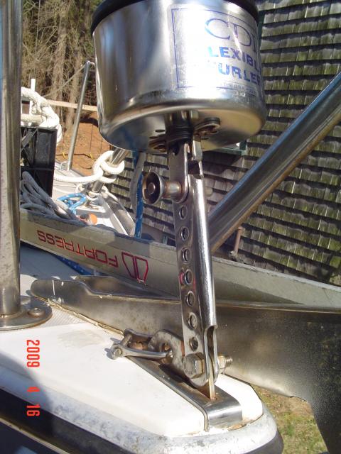

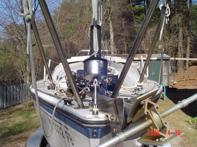

I only use one of these for my furler. I keep the rest of the stays connected and I bungee them to the mast when I trailer my boat to and from the ramp. I haven't had a problem doing that, and I've always made sure that my stays didn't get kinked. This has always saved me a lot of work and the Handy-lock on my back stay has always allowed me to tighten or loosen everything up to get the furler on and off. I'm not sure if that can be done on other boats though.

Have you considered a "Johnson Lever" (or some other brand) on your backstay? We step the mast, rock it forward to pin the furler then close the Johnson lever and place a small pin in it to keep the lever from snapping back.

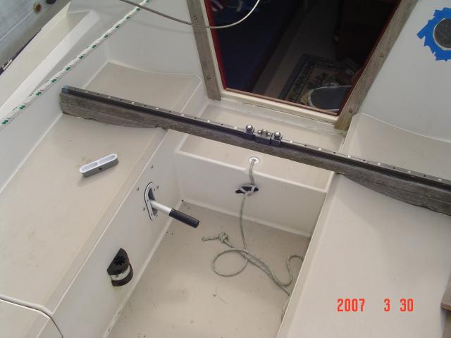

I have the Johnson Handy-Lock on my back stay just below the open turnbuckle right now. I bought it used at Rig-Rite back in the late 1980s and had them install it for me. My mainsheet used to come of a triangular plate on my back stay and I hated it, so I bought a cheap Nico Fico traveler and mounted it in front of my companionway on a piece of Teak.
The Johnson Handy-Lock has a lever that screws and unscrews the swaged bolts. When you close the lever, it locks the nuts in place on these bolts. The Johnson Lever is undoubtedly faster, but the Handy-Lock does the same thing and only involves a little screwing. :D
