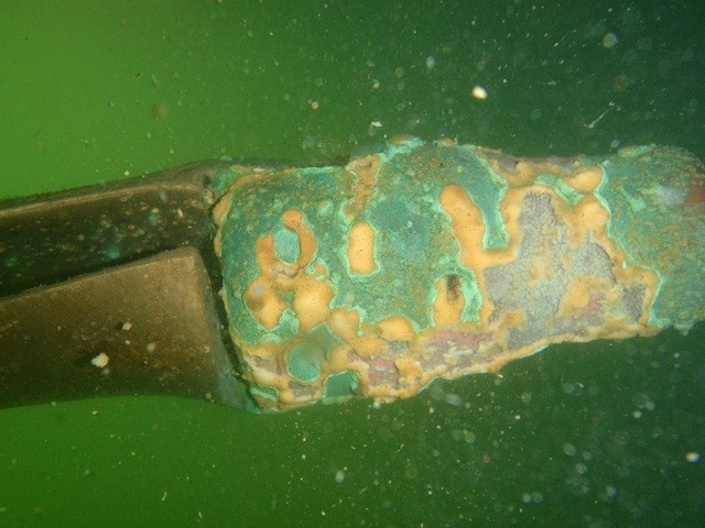

Did Jerry ever find the source of his electrical problem?
-Will (Dragonfly)
Feb 26, 2011
1,440
Achilles SD-130 Alameda, CA
He was convinced that it was the neighboring powerboat. That is until his bilge pump failed and his repair guy found some broken insulation on a 12-volt wire. New pump, problem solved. But the damage was done and prop was lost in the Bay somewhere.

He was convinced that it was the neighboring powerboat..
In every case of severe corrosion I have yet to see an owner not blame it on someone else or the marina. The vast majority of the time the source is their own boat...
Jan 30, 2012
1,150
Nor'Sea 27 "Kiwanda" Portland/ Anacortes
Affirmative and correct on the West Coast too. The geographical proximity aside -- the neighbor can hurt you alright but the rate usually won't be near the rate as if it came from your own DC system. He (she, they) just cannot muster the current density necessary to torch your metals at such a high rate. And - if you have galvanic isolation you can be certain you are the problem.
So if you see sudden onset of anodes disappearing quickly (or the wheel falls off) - check your own boat first.
Charles
Mar 20, 2004
1,749
