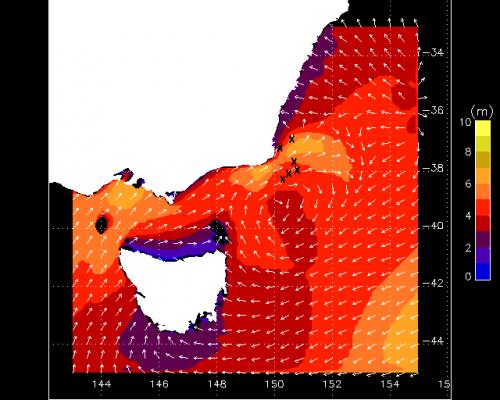

Speaking of waves, why is it that forecasters give the average wave height? The average wave is not what gets boats into trouble, it's the max waves. Case in point, during this race, the average waves during the worst part of the storm was 9.4M, but the max height was about 15M. That's a hugh difference and most boats can't handle 15M when the shore is down wind (can't run because no place to go).
I was wondering why they were beating into the waves and after looking at the wave model, the sad thing is, all boats that capsized had plenty of room to run as the waves and wind were blowing out to sea or along the shore line.
44 boats completed that race and only one (the 80' American race boat) was fast enough to outrun the really bad stuff plus, I believe the 6 boats that capsized were in the lead pack (the bigger faster boats). Also, as you can see from the picture, the ones in the rear may not have had as bad of waves, but they were blowing towards shore and would have been on the beam if they stuck to the rhumb line, so now I'm very much interested in what the boats that finished the race did to handle the storm.
The boats that capsized told us what not to do. I'd like to hear from the boats that can teach us what to do.
