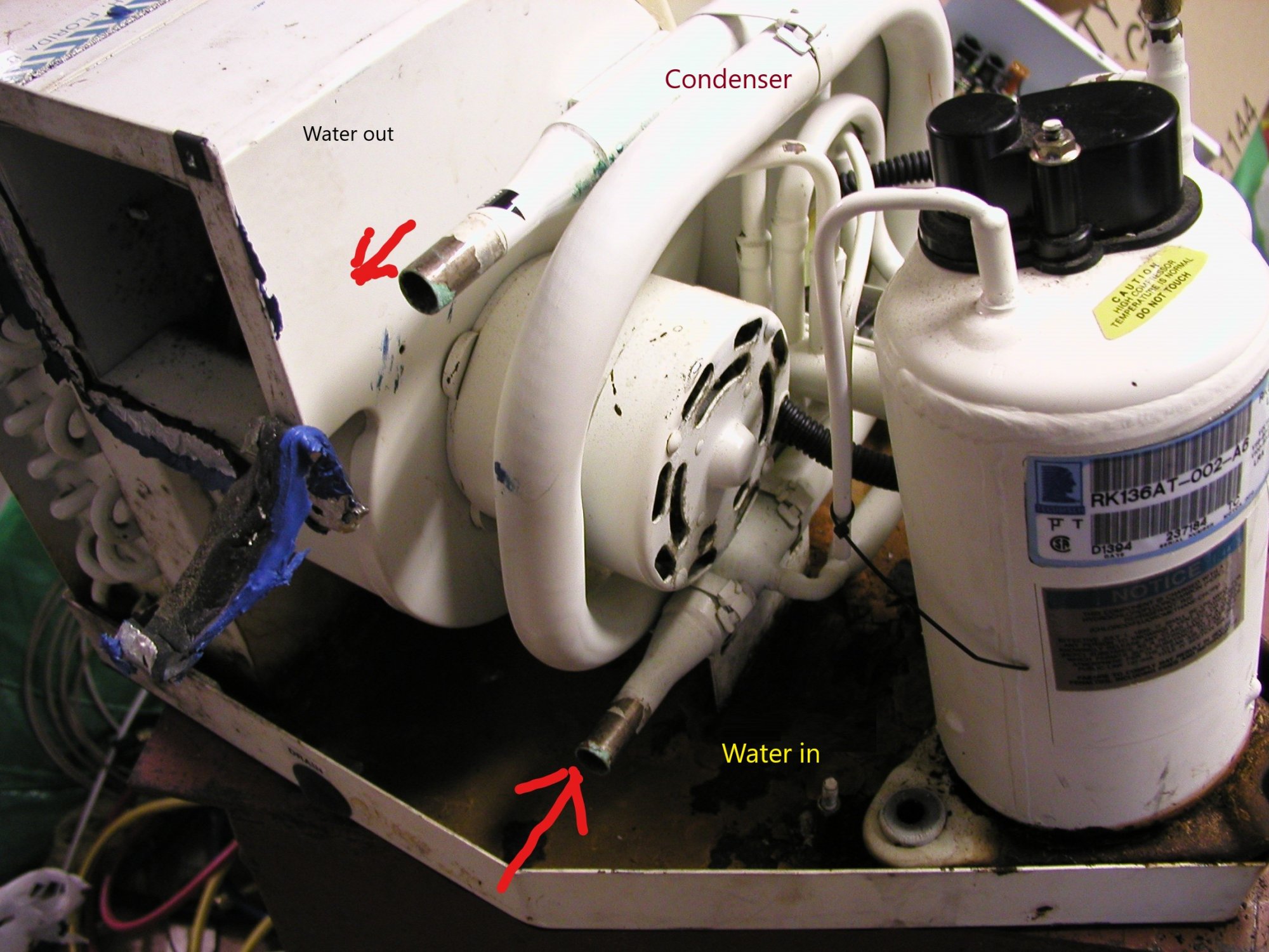

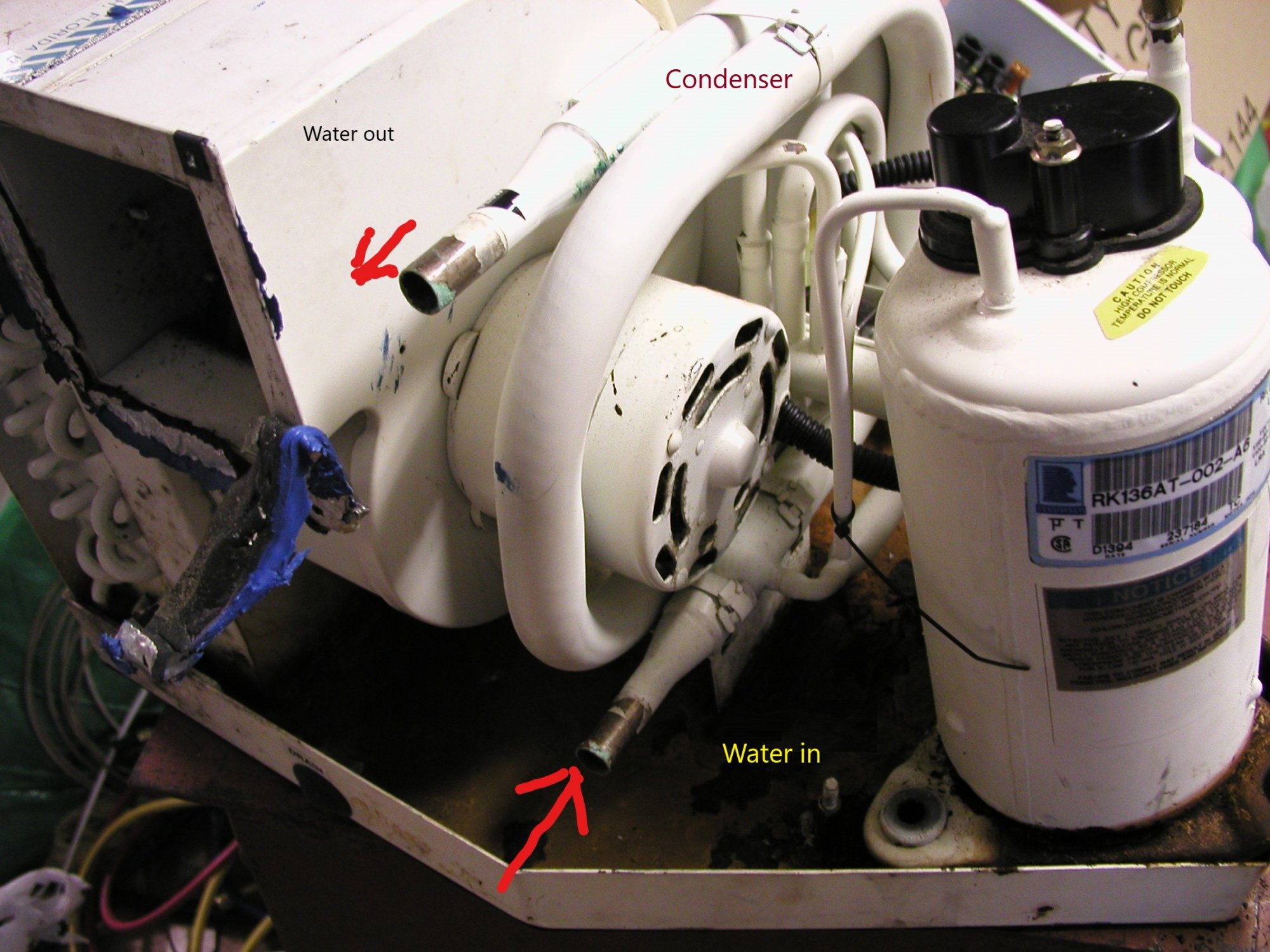

Yup, that breaker is usually attached to the top of the compressor case .. These are set for some pretty high temperatures depending on the compressor itself. The rotary compressors run quite hot normally.
The black "pod" on top of the compressor (in the attached) houses the high temp "protector" This would be the first thing to trip on loss of cooling water flow from a plugged strainer, closed thru-hull (?) or otherwise fouled water intake.. another hidden trip is internal to the sea water pump itself . A bad motor or restricted water flow will overheat the motor and the temp trip will open. It also resets when it cools a bit.
