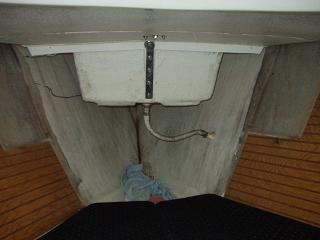

Ed, I will try to send one photo
showing the original locker from the v-berth perspective, with the cabinet/partition removed. Just curious, but are you intending to locate the chain locker floor at the level of the berth platform, or below. All my rainwater ( home port Seattle) ended up nicely stored in the forward compartment/locker under the berth, which is sealed off from the larger/aft storage compartment. So the forward compartment, under the berth and under the original anchor locker, would be suitable for chain storage. One nice aspect of this locker project, is that when your spouse calls the boat and tells you its time for a sail and she is bringing lunch, you can pretty much drop your tools and enjoy the afternoon.

I'm to stiff to cut limber holes but
I did install a drain in the bottom of the new (and we hope )improved locker, which required lowering ( drilling a hole in an otherwise good hull) the locker drain through hull. I am attaching ( speculative) a photo showing the space waster locker that was cut out.

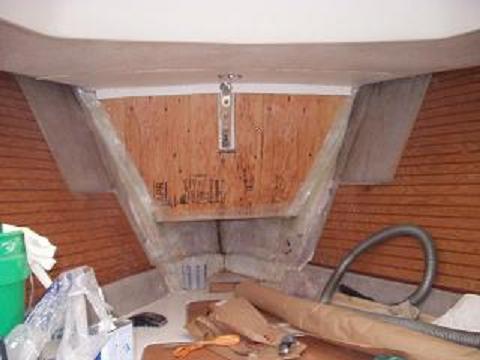

Hey, another milestone
in my computer skills. So from the previous post you can see the locker with the interior woodwork removed. The gray squares on the hull sides are carpet where the cabinets were located. The rag under the locker is sitting on the most forward part of the top of the forward berth locker. The hanging locker pan does not extend into the bow, but ends approx a foot aft of the bow. When water would come in through the deck anchor roller plate/winch area,it apparently would drip down the hull and end up either at the v-berth platform and then into the cushon. Or, what the previ.vous owner did, was divert the water into the v-berth forward centerline locker by drilling a hole where the berth platform joins the hull at the most forward point. This berth locker ( on my '85) does not have a forward partition, you can see the hull sides coming together in the front of the locker. If sucessful, I have attached a photo showing the back/aft side of the new deck anchor locker. This might better show that the berth platform extends to the bow/forepeak and can catch water dripping from the bow roller fitting.
