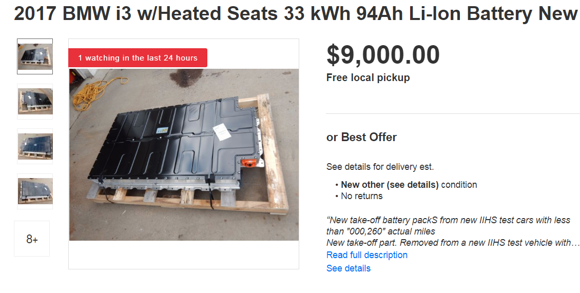

I read somewhere, people are using BMW hybrid batteries. By some simple calculations, something like below would run a ~ 30 hp motor for 10 hours. Probably weighs 600+ lbs, without any drive train.
