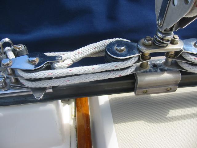

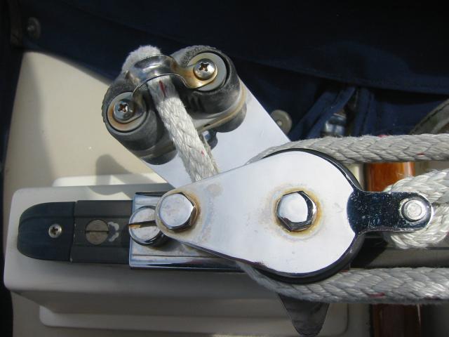

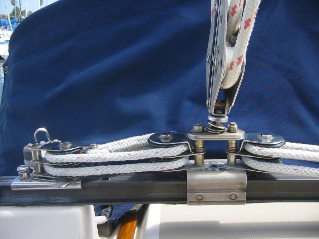

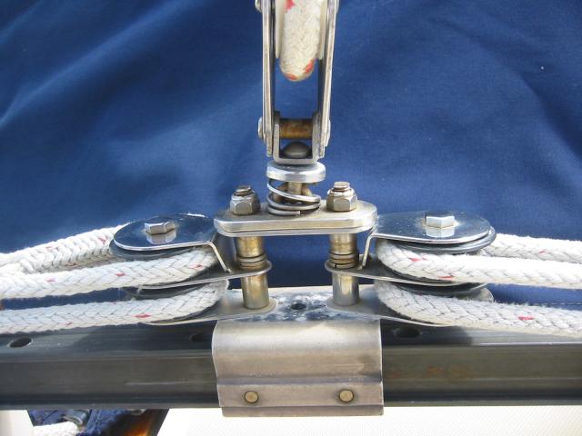

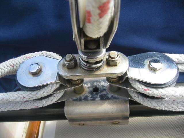

Some years ago I bought just the blocks and control ends from Garhauer to modify the traveler system on my 1985 O'Day31. They were from what now looks like their MT-1Traveler.
I used my existing track and traveler car (pretty sure they are Schaefer). Back then they semi customized the control ends so they would swivel and allow the traveler line to lead fairly through my existing dodger. Had to modify the car a bit to get the new blocks on but it has worked well. They are a fairly small company and will work with you.
It was a huge improvement over the PITA pin stop track ends.

Sorry, I got soo excited I hit the post reply button. Were the end blocks that you are showing modified or custom pieced together, or were they supplied totally complete by Garhauer? Did you use Garhauer for the blocks attached to your traveler car?

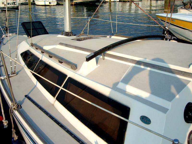

But honestly, I have no idea what "arched" track is... is it curved or something?
"Arched Track" means the standard type of track is formed into an arch to match the deck or cabin top "crown" (curve).
Here is a traveller on a 272, note the "arch".
Garhauer supplied all of it except for the longer bolts I needed to extend the mainsheet block up from the traveler car.
The end blocks are essentially the same as the end blocks on their MT-1 traveler. They did customize those a bit to make them swivel but in hind sight I really didn't need them to swivel.
They also supplied the blocks that I attached to my existing traveler car. Again, I think those are the same blocks as on their MT-1 traveler.
So what I think you want are the blocks from their MT-1 traveler without the track or traveler car.
Check the dimensions of your track and, as eherlihy said, "call them". Guido, who was the traveler guru, passed away a couple of years ago but I'm sure they have someone else who will help you. If they need to customize something for you they will. I think they build them to order anyway.
