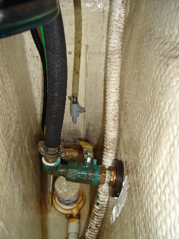

I tend to think that all seacocks and thru-hulls should have a backing plate, but maybe that is overkill. I know that I have a thru-hull in s similar location and it has a piece of wood for a backing plate.

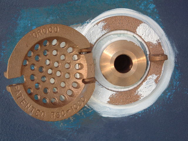

As for an outside plate, I would work it inside for a more esthetic job. I'll see if I can add a picture to the post later- edited to add two pix, one outside of the thru-hull with hinged cover for cleaning and the inside with a round wooden backing plate.
