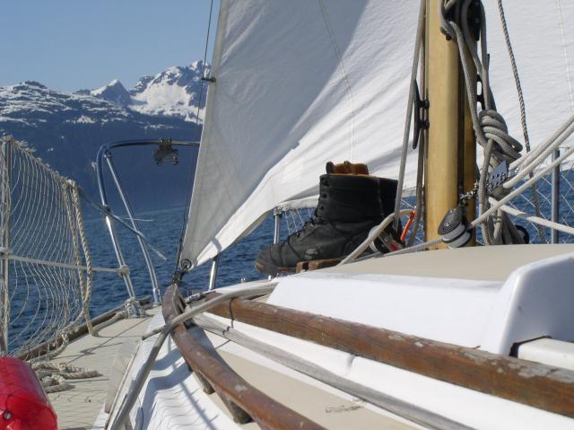

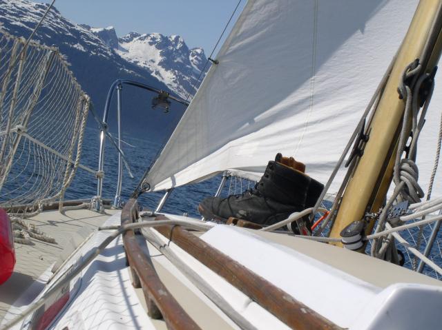

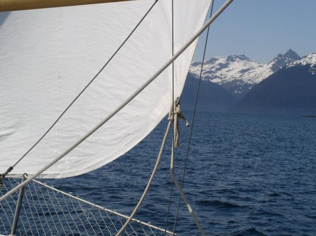

Does the jib sail look right?
geehaw
May 15, 2010
231
O-day 25 shoal keel Valdez
I have attached a few pics here. I was just wondering if the way the jib is fastened and jibsheets look right to all. the jib sheets allways catch on the shrouds and the jib some times catches on the fore stanchion. And it chaffs on the life lines. So I was wondering if the jip should have a line from where it attaches to the bow up to the tack to raise it some?

Run the sheets on the outside of the shrouds, that will help. I had the same problem with my jib, I ran a line through a block to the foot of the sail, I hoist the jib and pull it tight from the bottom with the foot a couple of inches below the bow pulpit. The sail fills and tacks a lot better this way.
Jan 24, 2005
4,881
Oday 222 Dighton, Ma.
You can raise your Jib up about 12" by adding a tack line between the bow plate and the sail. This should prevent the sail from chafing on the bow pulpit.
