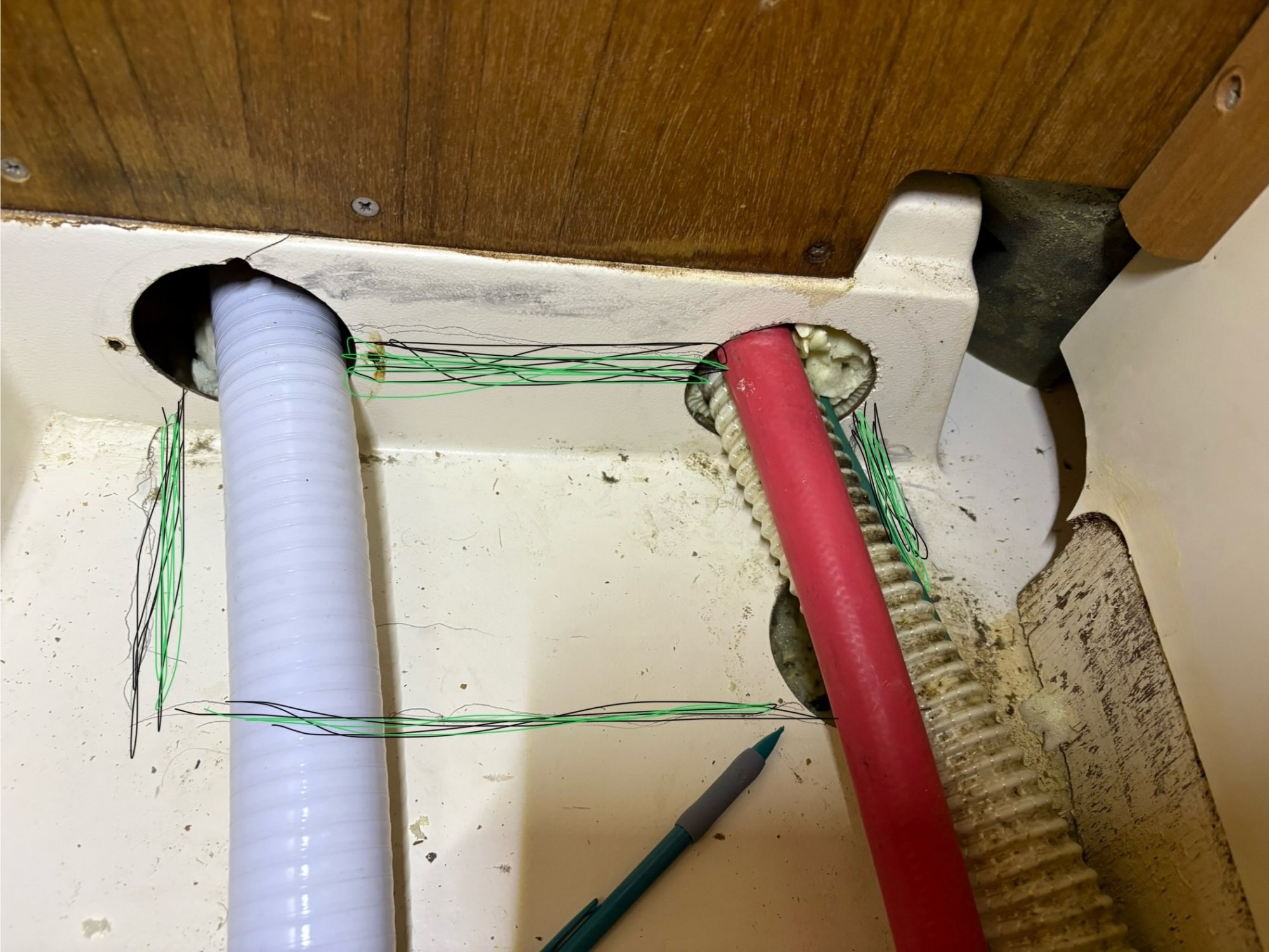

I ended up gaining access to the space below the shower pan buy cutting into the space where the sanitation hose emerges from below the shower pan. It is at the foot of the bed in the aft cabin. The pix below shows where I made the cut. The hoses emanating from the hole on the right are the manual bilge pump hose and a raw water hose for a cockpit washdown.
Jim

Good morning. I'm not sure my experience will be helpful for you. Because my access was so limited I had to get very creative. I used a 3ft length of threaded rod to perforate the foam I could get to, and then used a couple of nuts to secure a washer to the end of the rod so I could push at the foam to break it up. i iterated back and forth between the hole poking and the washer pushing/pulling for hours and hours over many days. I tossed a couple of inexpensive headlamps into the space and used a borescope to guide my efforts. I pushed a shopvac hose into the space to clear out the bits of foam I was able to break free. I had a few areas I couldn't access with any tool I had on hand and so made hooked tools of various size and design by welding bits of rebar together. It took a lot of patience, time, and boat yoga.
