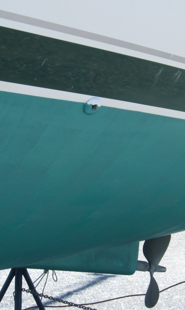

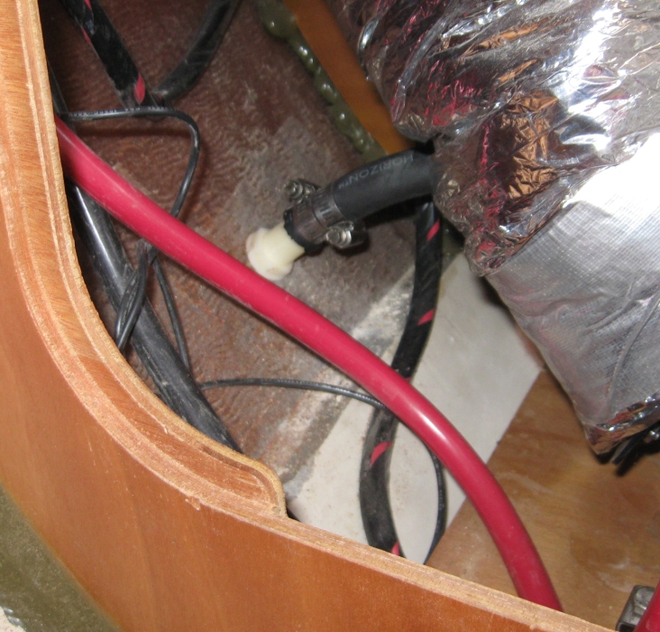

Should I change this out for a bronze thru hull with a In Line Ball Valve (probably will not opt for a Flanged Sea Valve here) or leave it be?
The attached pictures of my 2001 Beneteau 331 are of the discharge side of my air conditioning. You will note that the outside hull picture shows the exit position just at the top of the bottom paint. The static water line is about 1-2" below that position. Very low IMO.
The interior pictures show a simple plastic or nylon thru hull. I am pretty sure it is not marelon because the color is different. This is how I purchased the boat. I think the A/C was a dealer install as most are. Not sure the factory ever does these.
Advice? Does anyone out there have the same set up?
I looked at other 331s and they seem to have a much higher exit point.
Changing it could mean skipping my place in line to get splashed this week... not to mention the cost which I would estimate at $300+.
I am concerned about this A/C discharge thru hull. It does not look well installed to me even though it probably would pass the ABYC H-27 thru hull recommendation specs on a technicality (27.5.1 exception #2) but I am not a marne surveyor or marine lawyer. I try to operate on what little common sense I was given.
