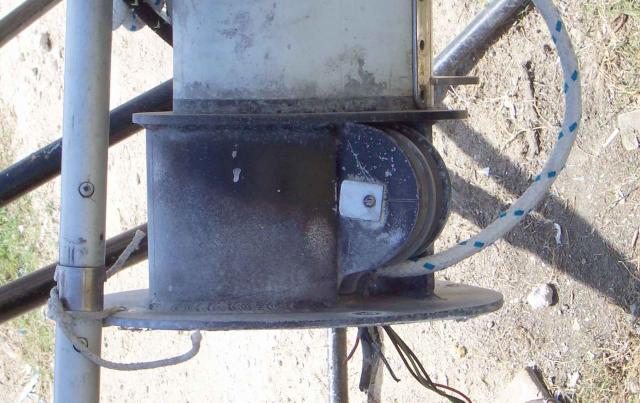

Mast step won't come off the mast - Hunter 33 1981
I've attached a picture of what the bottom of the mast looks like. We have since been able to remove the top of the mast (truck?), and see the conduit and halyards...lots of space for the new wires.
However we have not touched the base/pulpit/step as I prefer not to try anything like heating it yet.
Any ideas on how to get it off?
Does the step have a collar that rides inside the base of the mast?
If so, how high is it?
Many thanks again for the assistance.
