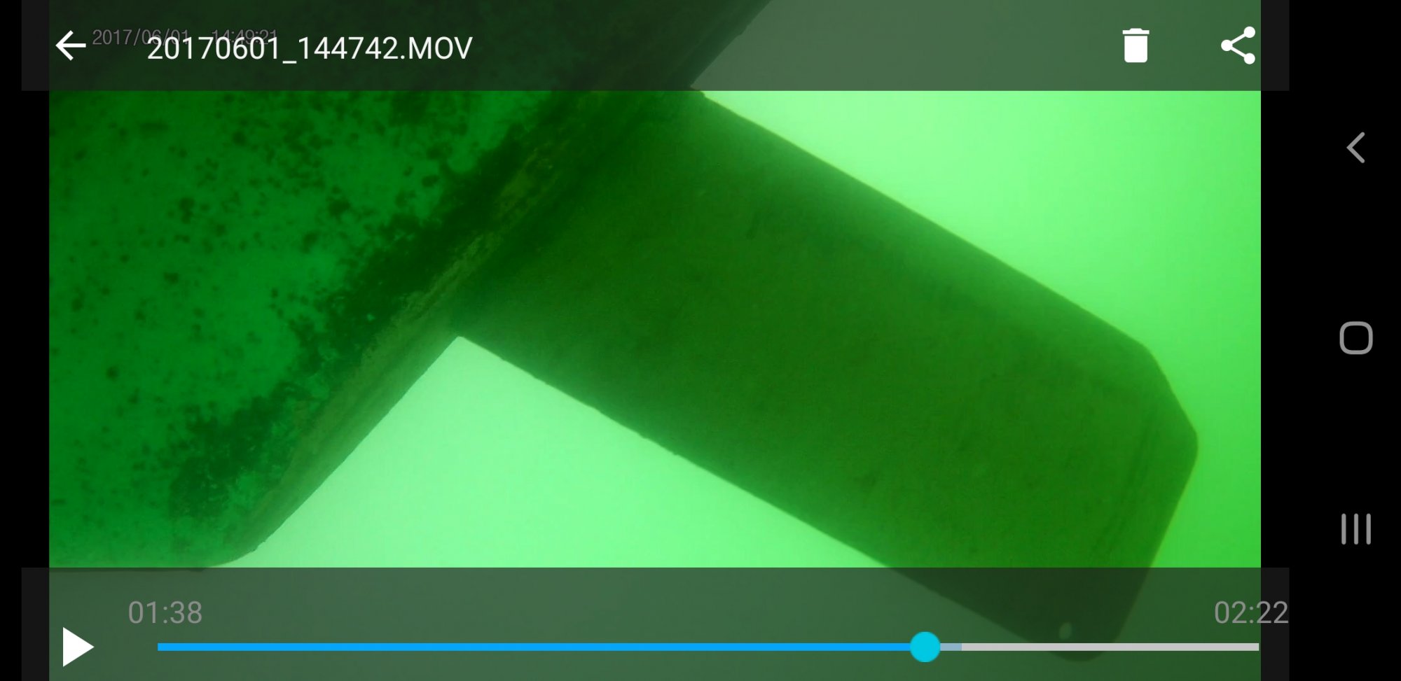

I've used my knock-off GoPro attached to the boat hook. I set it to record so I'm not dependent on the wireless, but it may take a few attempts to get the right shot.
