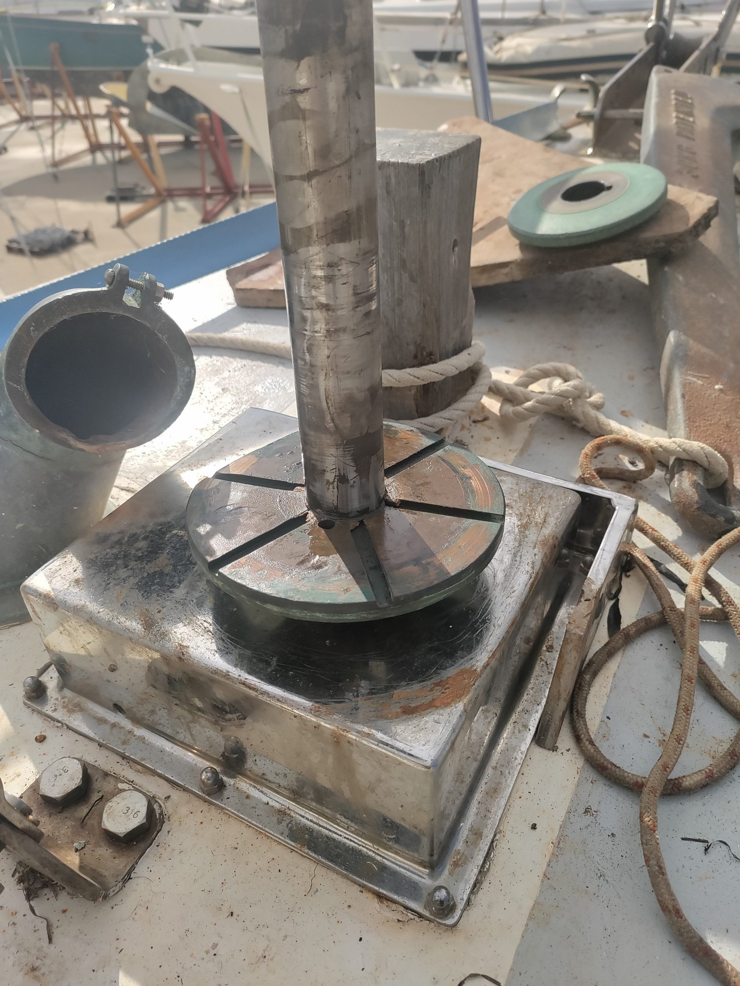

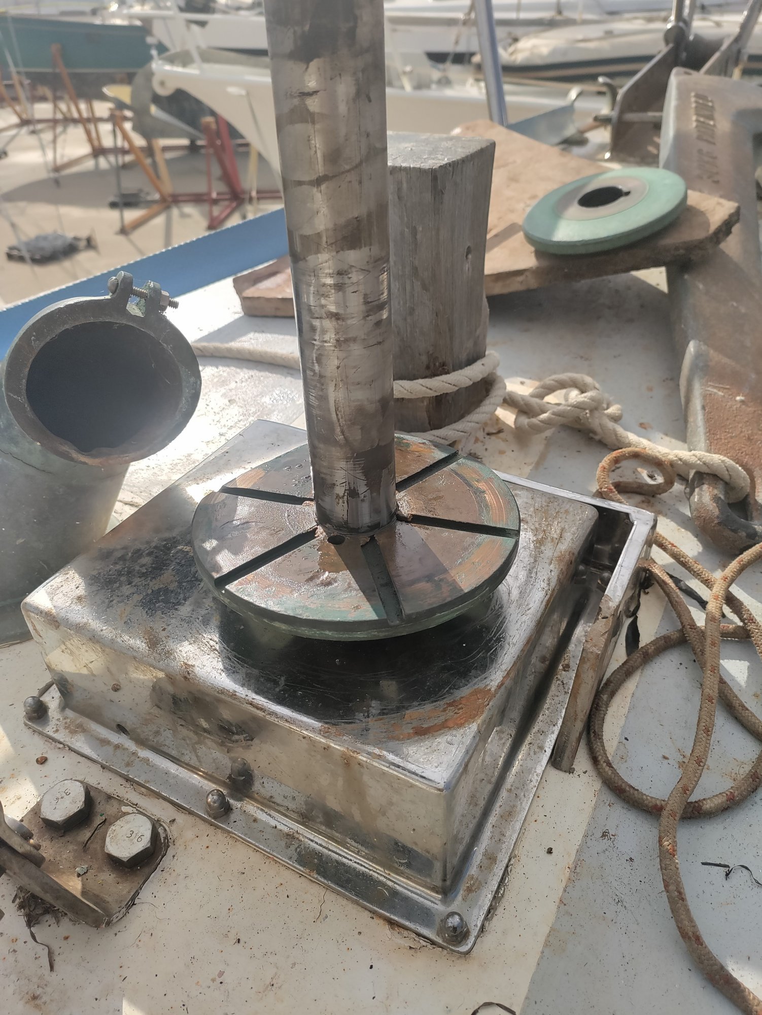

I was hoping people could help me identify the windlass on my boat (see next two pics). Any pointers towards identifying it would be great!
My intention is the disassemble the windlass for general inspection and maintenance now that I am finding myself on the hard for the winter.
The real problem I am dealing with is trying to remove the plat under the wildcat (see next picture) I was hoping that identifying the windlass would help me to find the manual whoch could then further help me to disassemble the windlass.

Hi Johan. What a beast of a windlass. Perhaps if you were to access the motor/gear assembly below deck, that would give you the brand and model. Our boat came with a different windlass than yours, but that is where I found the information that I needed.

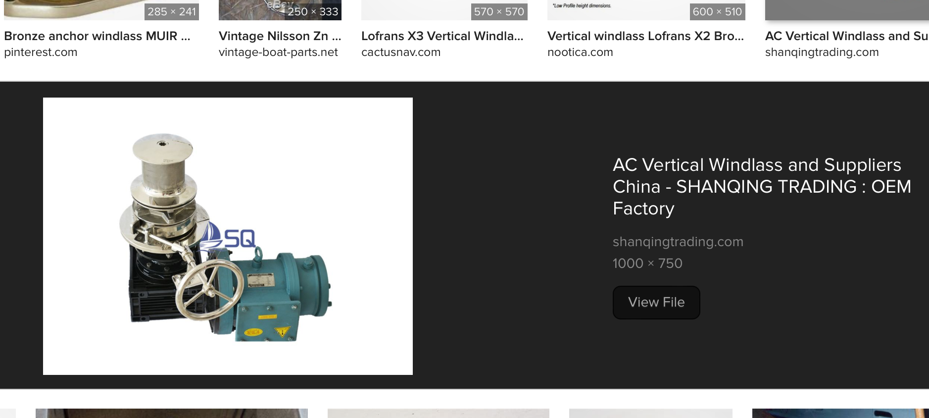

Thanks for your reply. I can see the motor below deck. Unfortunately, the name plate did not have visible writing on it. The only writing I can make up are the letters A H (and I think C??) on the very top (see 2nd picture). But lot's of googling (also submitting the picture above to image search) has not been provided me with any further clues. The prvious owner also doesn't know the brand.

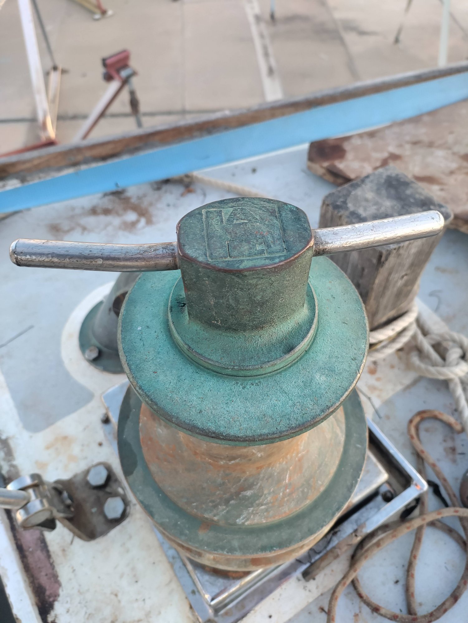

The capstan appears to have an A stamped in the bronze. Can you identify any of the letters on the top? Is the drive electric or hydraulic?
Yes, I have identify the smaller letters as A and C, and a central large H? And yes, I have been asking google about the letters :) The drive is electric.

In the mean time, I have been talking to people at the boatyard and at the bar. The beers have paid of. Someone just passed by at the boat and was able to at least confirm the mechanism that holds the base plate in place. So now at least I know a next step in the disassembly, which hopefully, brings me closer to accessing the gearbox.

I have essentially given up on trying to identify the windlass. I have had some other people looking who have seen more different types of windlasses and/or electric motors. So with their ideas I was able to take off the base plate (fixed with a roll pin through the shaft), access the gearbox and finally take off the electric motor. The motor has been serviced: put new brushes in and cleaned the commutator., and it works! I will paint the outer casing of the motor and then the windlass will be ready for assembly!
