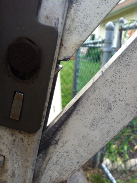

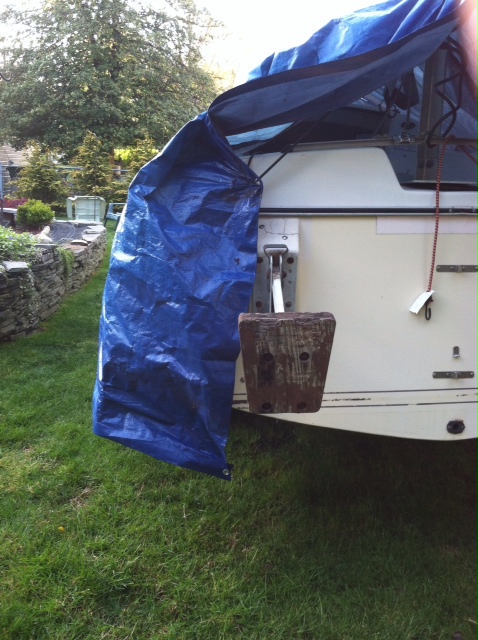

In the 2nd phot you cans see the u shaped piece that needs to be pushed down. In the 3rd photo you can see the notch in the bottom of the top arm near the silver plate.

Bite the bullet and buy and properly install a new OB bracket. The type of bracket you currently have doesn't seem suited for the weight and torque of a 60 lb 4 hp motor. Perhaps more importantly, it appears in the second pic that the mounting area for your current bracket is cracked. If so, you'll need to properly repair that area and build up the area behind it inside the transom for a new mount. You will be amazed at how easily a new and correctly sized bracket will make raising and lowering your motor. This isn't something you want to be worrying about.

Looks exactly like the engine mount I have. I screwed a block of wood on top of the U-shaped locking bracket, so I could step on it, then pull the engine up. A strap on the engine to use to pull it up is a good idea. I also extended the starter rope so it reaches into the cockpit, so my wife could start the engine. With the added block, she can raise the engine also- she's 5'2, 110 pounds
You can find new springs to increase the weigh capacity also. Good mount- been using it for some 10 years now

The cracks seen in the photos are in the gel coat. I've hung my 230 lbs off the bracket and there is no flex in the cracks. I carved them out a bit in prep for filling in so they look worse than they are.
