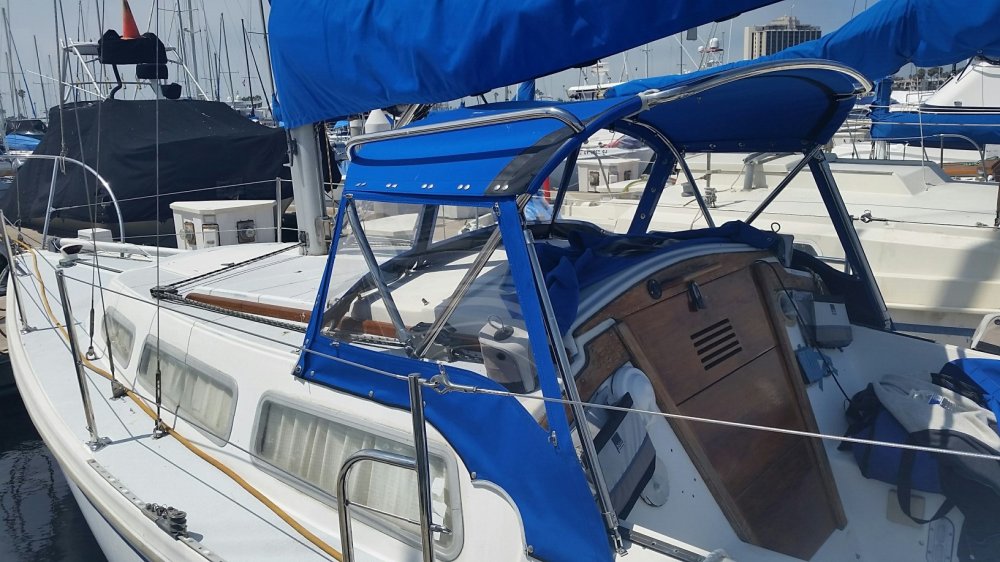

Not really a comment.... just wanted to post a pic of my $3100 investment.... it was a big "gulp" to pull the trigger on this project but... in the end I couldn't be happier. With all the benefits the dodger provides... such as protection in the cockpit and allowing the hatch to stay open most of the time.... I found the greatest to be the handholds for safer boarding (specially for us old folks) and moving forward. I chose a "see over" design that allows me to stand for great visibility while holding the rear grab bar. In really hot weather the side panels can be removed, the center windshield panel lifts up for air circulation...
