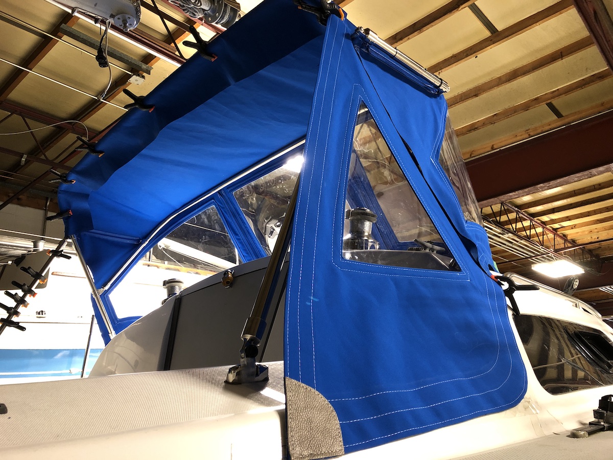

The dodger is an order of magnitude more complex than the bimini. Besides the fit, the commentary about simple space is a good one, I pretty much filled the kitchen with it, I used the mid sized strata glass, and leather handholds and trim. A household machine would never have survived, and a walking foot is a necessity. I bought a knockoff machine, and I've seen two versions of this very machine that would not run out of the box. Mine is starting to sound a bit "worn".
Building a Yanmar is easier. The bolts only go in one way, and they don't want to stretch or move around on you, and they don't alter their trajectory as you are turning the wrench. Fabric has a nasty tendency to want to wander, and that results in stitches that are not straight.
Here is the assembly going together. I adopted the sailrite methodology of using "ShelterRite" as an edge liner. This stuff is cool, its a vinyl/webbing sandwich, and it does not seem to stretch. There will be no flapping. We will see once out in the real world.
