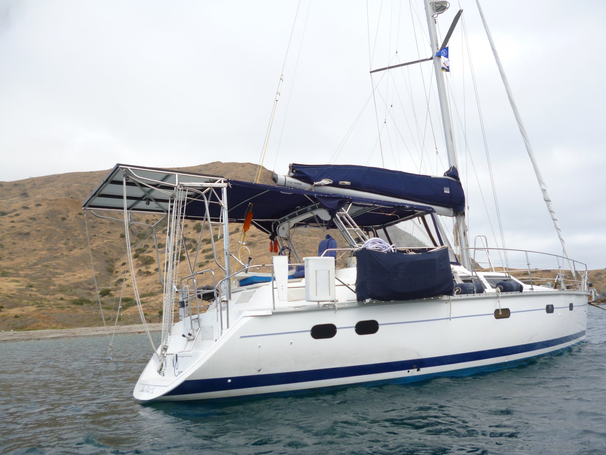

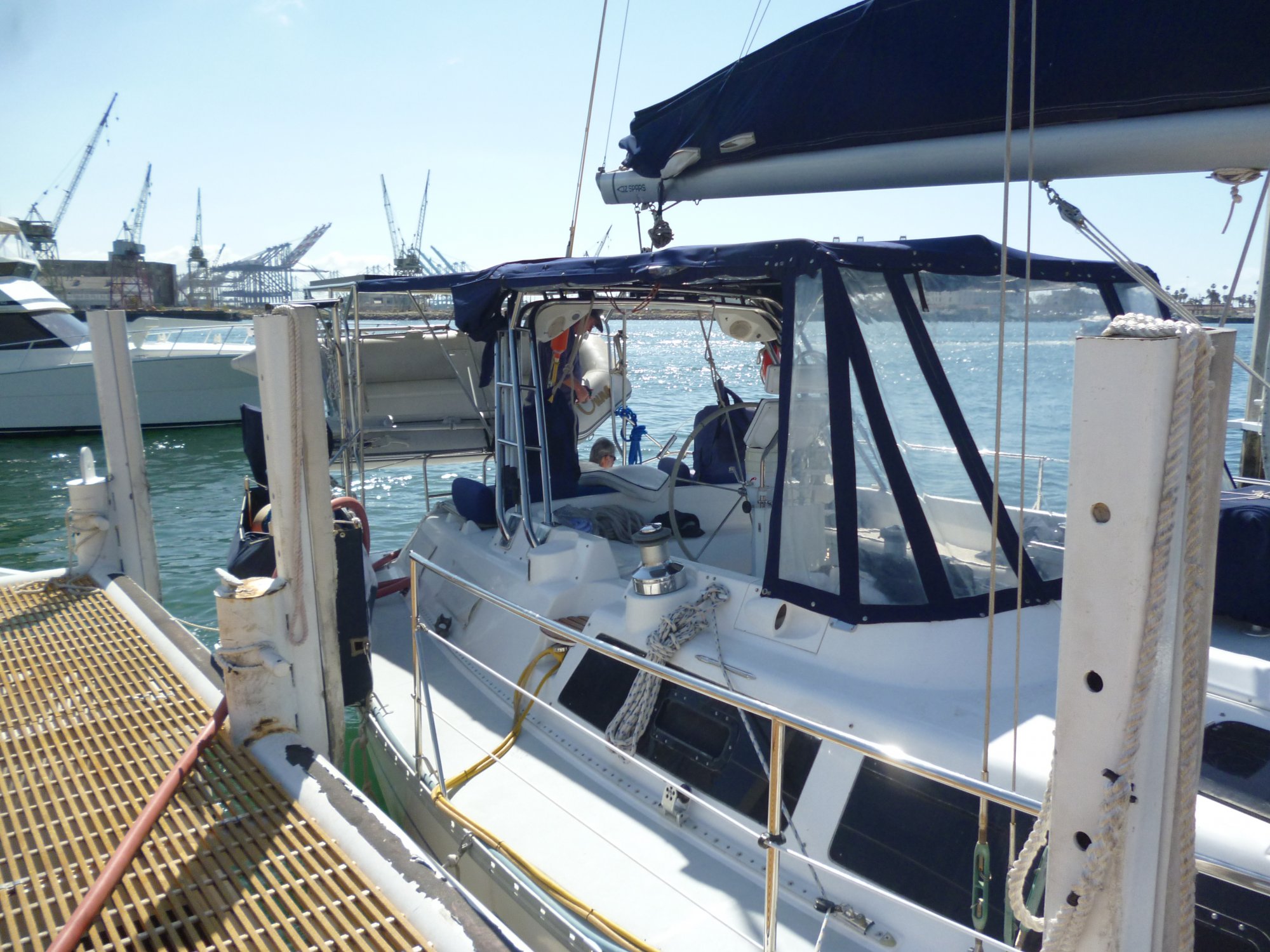

As mentioned, height of the boom will be the governing factor. My dodger is high enough to stand under and it was possible to have not only the dodger, but a full cover that extends to the boat's aft. The entire frame is Stainless, for maximum strength, w/ many handles added since the enclose picture was taken. Given this design one always looks through the dodger to see forward.
The cover has removable side panels that allow full enclosure in nasty weather. Use the most UV resistant window material and also keep the windows covered when not in use - UV eventually will damage anything see-through... The UV resistant Tenara (Gore Tex) thread is well worth the extra expense!!! Also, for best UV protection use black thread. From much experience sewing boat canvas I have learned that black ALWAYS FAR OUTLASTS white.

Whoa! That's a dodger.
How do you sheet the boom?
-Will
The sheet travels back through the boom and eventually, through a stopper to a which. Winches and stopper sets are on both sides of the cabin entry. Unfortunately no pictures of the stopper/winch set-ups. The attached picture kind of shows the main sheet,
