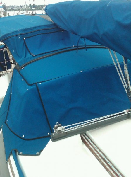

I love my bimini and dodger. I have said this and I will re-say this. Make sure you get window covers for your dodger. Don't leave it on all season long because it will shorten the life. If you leave the boat for a long time take the dodger off. I take mine off every winter and this winter I will re-stitch my dodger and bimini.

I actually made my window covers. The dodger didn't originally have covers for the windows. The dodger was a 2004 and I bought the boat in 2005. The windows already had a little haze to them. Since I covered the windows the haze hasn't worsened.

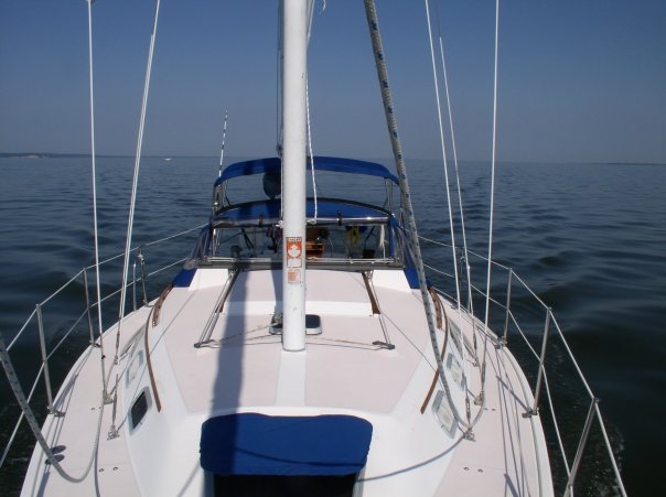

You will see that the height of my dodger is so that when I stand I can see over the dodger. I have a connector between the dodger and the bimini also.
Spend the money now and buy a GOOD dodger. If not you will pay for it later when you replace it.

the more this thread goes on the more i realize the difference in dodgers. my twenty year old factory dodger has no real issues with window clarity, but plastic is plastic so we generally sail with the easily opened ceter panel open. what do you guys mean by window covers. also i have a full length bimini that extends from the aft end of the dodger and i also guess my dodger is as tall as they come since it just clears the boom - just. i also have slits - not original - in the quarter windows so my traveler line gets led aft. i know it's a factory dodger since the first owner left the original bill of sale on the goat.
23,008
t what do you guys mean by window covers.
morty, go back and look at the pictures in reply #9
One really needs those covers to avoid the windows from eventually disintegrating after they fog up enough so you can see through them.
When I broke my leg skiing two years ago the covers weren't on and having other things on my mind, I neglected to have anyone go down and cover them for a few months. Cost a bundle to redo the glazing.

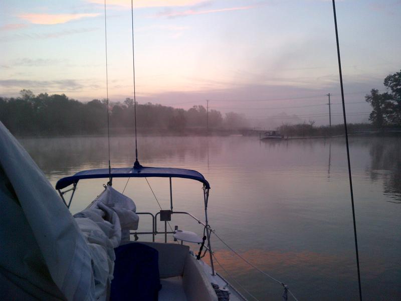

Got a quote 3 yrs ago for a dodger from one of the reputable Canvas shops at Riverside NJ. They estimated 1800 with frame/installation for a 1981 cat 30. I agree with prior posts-covers for plastic is key to helping it last as is removal over winter or prolonged periods of disuse.
As an aside, I did get a Bimini from the Chandlery-it is great. The quality was good and it has held up very well-was less than shop estimate (approx 1300 from chandlery if I remember correctly). One thing I would do is get windows in the bimini as this will allow you to see masthead without craning your neck around (they were recommended and I foolishly declined). Not sure how they would do with a Dodger, but they were very helpful and easy to work with for the Bimini if it is something you are considering. I have a posted pic.
