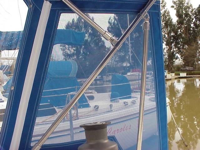

Here is a picture of mine!
Fred: This is not the best picture but you may be able to get an idea.
