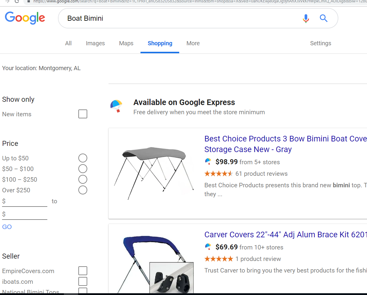

Biminis come in many different width and heights. measure the width of your cockpit from the middle of your gunwales and then measure the height from the gunwale to just beneath the boom.
With those measurements, you can go on-line and shop for a bimi
